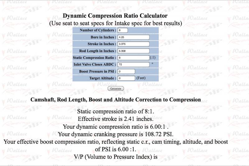

I entered your info into Wallace racing's calculator and it looks like your 383 is about 8:1. That 509 cam is KILLING your cylinder pressure. If I had your budget, I'd do this:
Step 1: Keep the 383 and just swap out that cam and lifters for some thing more reasonable. COST: $300 or so.
