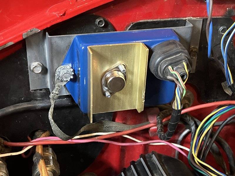

I had a chrome box for years, it crapped out recently. I now have this:
