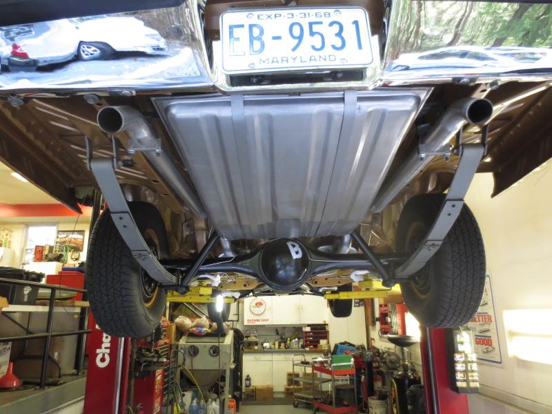

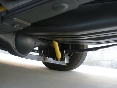

if you want your tank to blend in with other parts of the underside, i would go satin black. if you want factory look, go galvanized or bare metal. here's mine in satin black.
O.E.M. and Spectra replacement tanks aren't cadmium plated, they're ni-terne (92% lead - 8% tin) coated. Same coating as brake lines.
