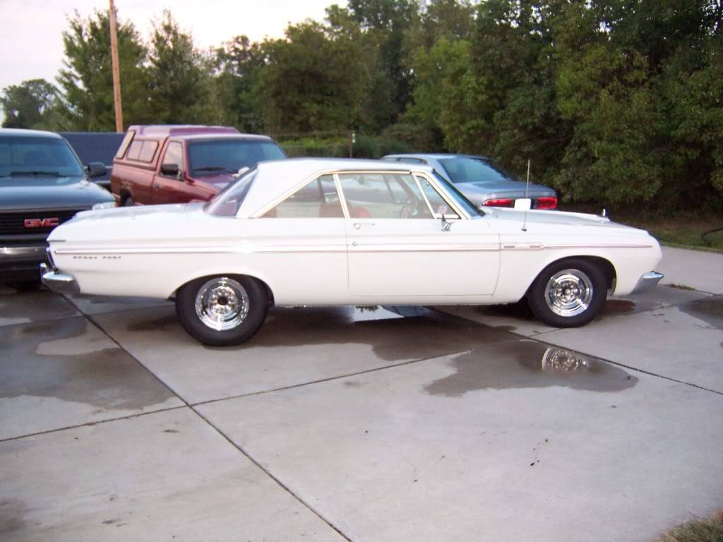

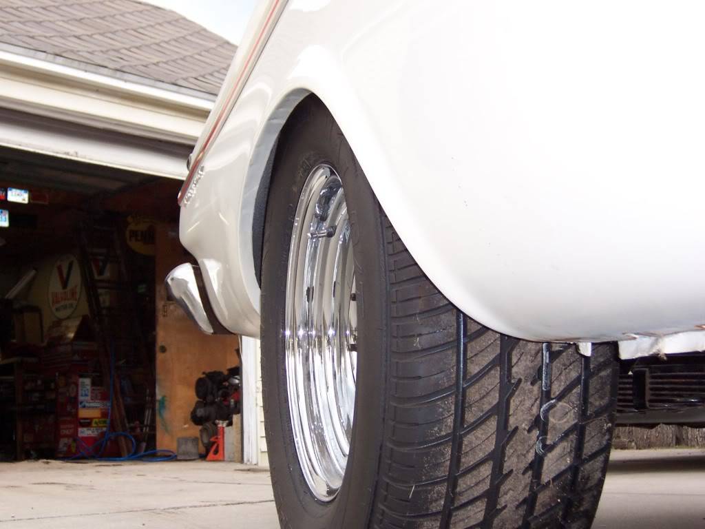

Still f@#$%&*@ with the brakes and the trans leaks like a baby,but I pulled the Sport Fury out of the garage for the first time in quite a while. Had to see how the stance looked(I like it!),and those way-cool wheels(good choice) and wanted to wash all the crap off her. It effin' sucks that I won't make Back To The Bricks or Woodward D.C.;but if I can swing a new trans or a timely rebuild of this one,I may be able to drive it. The saga of this car and me could fill a small book. Suffice to say that there's a "collector" in the Toledo,Ohio area that is far less than honest when it comes to cars he sells...I got burned bad,driveline-wise, with this one.
She's still gorgeous,IMO. I think owners of any '64 Plymouth hardtop,whether Belvedere,Fury or Sport Fury would agree that there's not a bad angle to the car. The boys in Highland Park hit it out of the stadium on this design.:yes:
The stance is just right;I might raise the front a wee bit-like 1 inch;no more-and the tires were the right choice. Now,as you can see,it's a little tight in back. Until I drive it,I won't know if they'll rub. If so,I'll have to get another $et of rear wheel$-OUCH! Those are 15X8,with a 4-1/4" b.s.;I've got plenty of clearance to the springs,so it's looking like 5" b.s. on the next set. Maybe they won't rub...

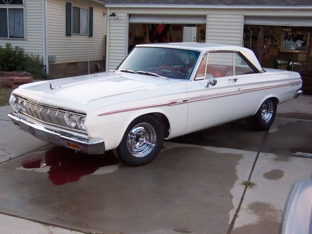

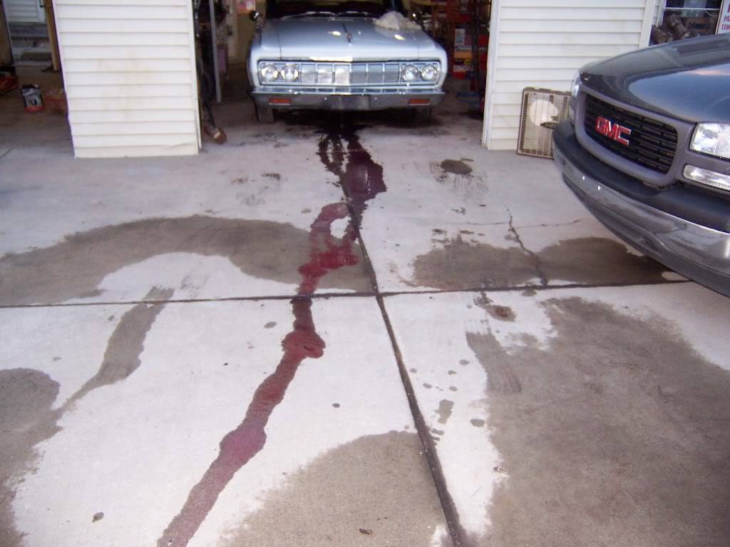

But...no driving her yet. The gf came out to water her plants,saw the puddle of ATF and said "Oh,that time of the month,eh?" :rolling:
She's been very supportive of my time working on the car,so I didn't give her any flack about it. She was smiling when she said it;she knows how I've fought the brakes and the trans and how bummed I am to not drive it yet. Soon,I hope...:steering:
I may just rebuild this trans,and put off the other engine and trans aspect until next year. I just want to EFFIN' DRIVE MY CAR!!!!!:cry::cry::cry:

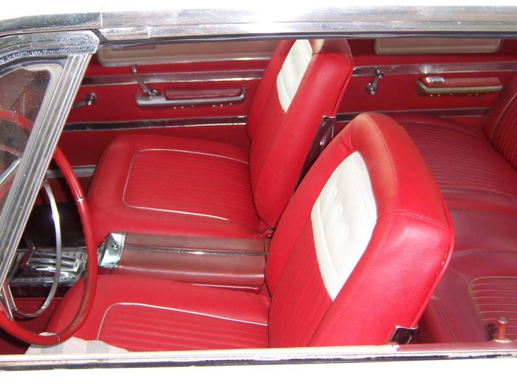

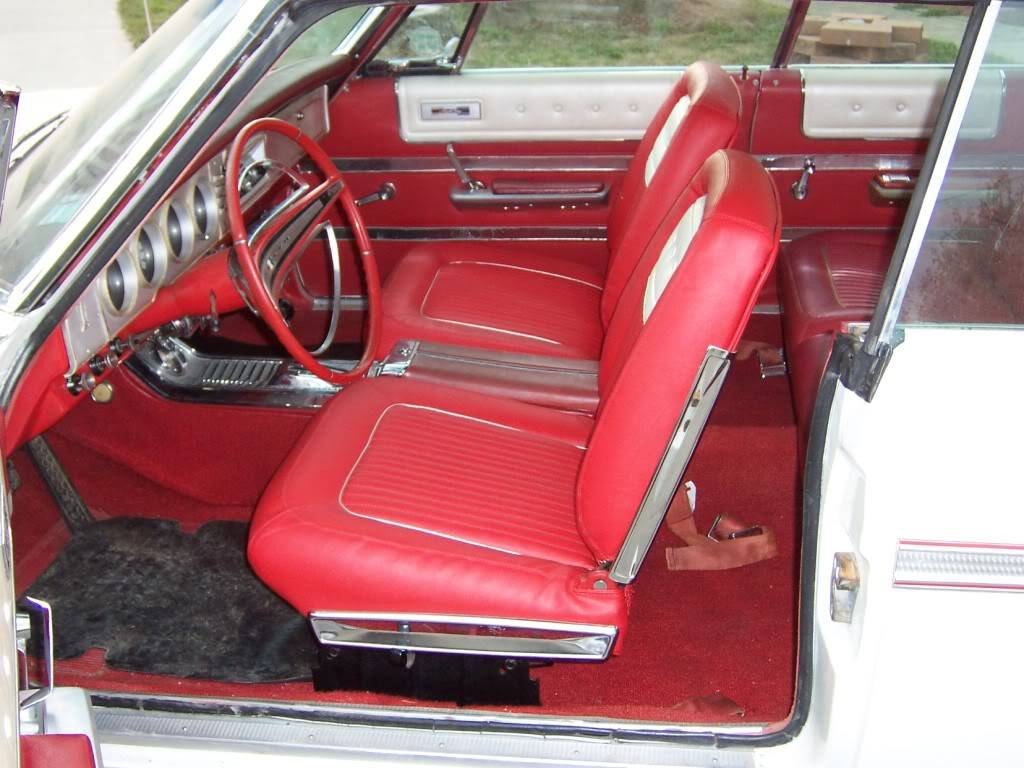

The original seats were cracking and splitting and the foam turning to powder,$oo-o-o-o...a call to Legendary Interiors(Just go there. Nowhere else. You get what you pay for,and I am more than pleased with L.I.'s products.:yes:) and we got these here purdy new buckets. Suh-weet! Comfy,too. You can see where the interior darkened to a crimson color over the years, The new seats look a bit out of place amidst the darker interior(they-the new seats-are the correct original color),but I'll replace that stuff later. Right now I just want to drive my EFFIN' CAR!!!!!! Oh,sorry;that was a rant.:yes:
Holy crap, that tiny bit of trans fluid looks like BP was trying to drill there in your drivewat,Ha! Car is looking "EFFIN' GOOD"!!!

is the the cooler line leaking or did the front seal blow?

PDFrogman;it's the main(pump?) seal that's leaking. I tried sealers;with the car idling in the garage,I minimized the leak. When I pulled her out of the garage to wash it,for whatever reason,the leak increased. I ain't going the "Oops;how did this brake fluid get into the trans..." bit-it's tempting,as the trans is in need of a rebuild anyway,but it would be a very temporary fix. Looks like a rebuild or replacement;I may just rebuild this one just to DRIVE MY FREAKIN' CAR! Sorry,I'm ranting again...

when u do pull it out who ever rebuilds it make sure the hub on converter is Ok
change pump bushing too

Where did you get those wheels!? They are bad ***. Looks like it time warped out of '64. I have a 65 Satty. Same color combo. After looking at your car I am inspired to get back to work on mine. I was thinking the exact same hing on the stance. One onch higher on the front and you nailed it. Great looking car and yes not a bad line ant where.
Wheels are from Rally America;15X5 front,15X8 rear. That company came HIGHLY recommended by a lot of folks for good units that run true. Might still have to go to a 15X8 with 5" back-spacing(these are 4-1/4") to clear the inner top of the rear quarter. Tires are 205/75-15 front and 255/70-15 rear.

You know;I forgot to mention the place that did the seats for me. I'm a maroon for this omission...
A-1 Upholstery,in New Lothrop,Michigan did the work,and they've done snowmobile seats and bike seats for me and a bazillion others over the years. They handle just about any upholstery job. They (Dianne and Bill Miller) also put on one of the largest vintage snowmobile shows and swap meets in the nation on their property. Top shelf,first class folks,and Dianne was recently inducted into the Michigan Motorsports Hall Of Fame for her achievements racing sleds many years ago.

That is one BEAUTIFUL Fury. Love that interior. Hope everything works out for you. I can't stop looking at the pics. Very sweet ride!
