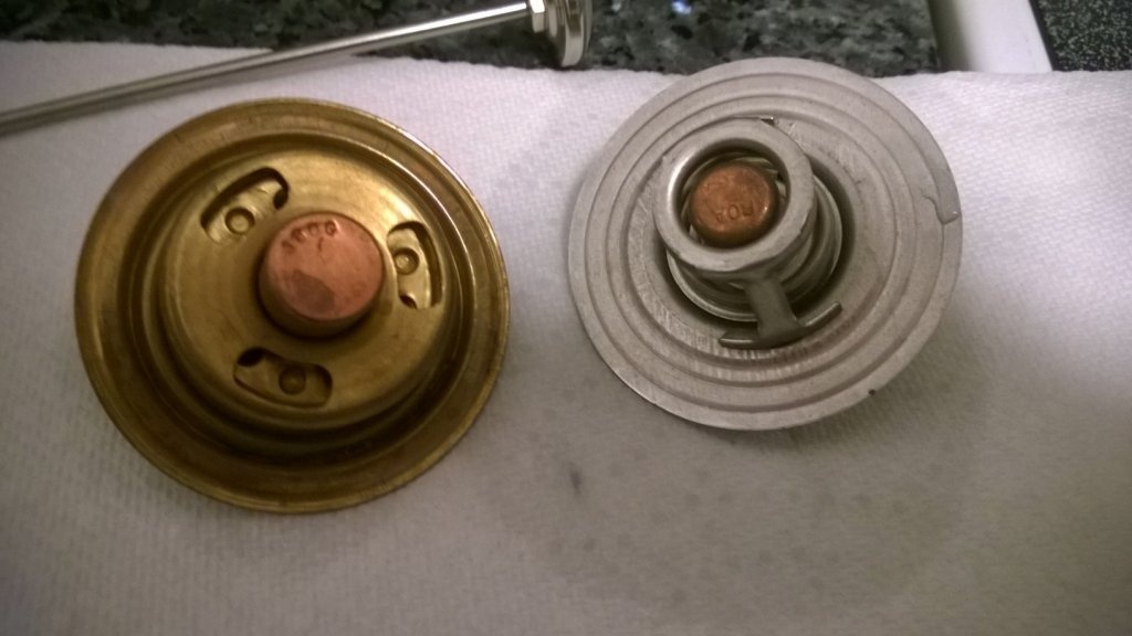

Fortunately it was the thermostat. I installed the thermostat on the left 4 years ago, I think it was a mr gasket 180 degree I think it was the one for 25 bucks. I boiled them up on the stove and the left one stayed closed while the right one (new stant 180F) opened. Not sure if it just failed or got plugged up with rust but it is not usable. I like the stant design, simple is good. So the boilovers were coming from the block getting superheated with no coolant flow.
I popped off thermostat housing expecting to have coolant fall out but it was bone dry from boiling with signs of corrosion. I took the thermostat out and bolted back up without a t-stat, ran about 20 miles on the highway and around town. Took a long time for the engine to get to operating temp as expected but once it did it stayed at 180F and didnt move. Heads, water pump, radiator, all 180F. With the old thermostat the water temp would bounce between 180-220. I'm tempted to run without a thermostat because it runs so cool, it doesnt run quite as well that cold probably will need to retune. For now I'm going to get the system flushed out and install the stant.

Believe it or not the only thing in there are wax pellets once over heated they are not the same need to be replaced but some of the material could have migrated out causing your issue glad to see your back in business see you at etown

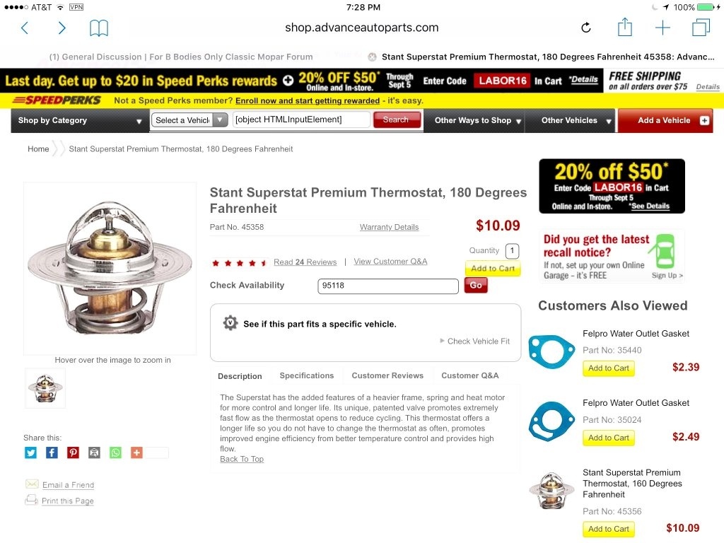

Napa carries the Stant Super-Stat 180. Reliable.
Thanks Dennis! I'm heading there tomorrow!
Advance has them too. Better check first. Mines been in for at least 10 years since the motor was done. Only $10.09 in my over-priced neck of the woods.
