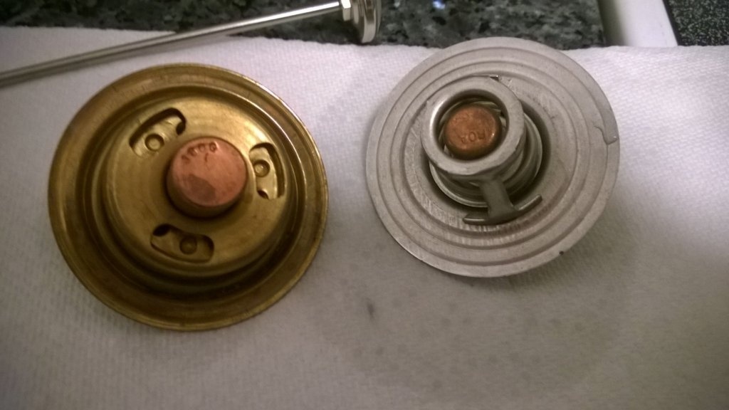

Fortunately it was the thermostat. I installed the thermostat on the left 4 years ago, I think it was a mr gasket 180 degree I think it was the one for 25 bucks. I boiled them up on the stove and the left one stayed closed while the right one (new stant 180F) opened. Not sure if it just failed or got plugged up with rust but it is not usable. I like the stant design, simple is good. So the boilovers were coming from the block getting superheated with no coolant flow.
I popped off thermostat housing expecting to have coolant fall out but it was bone dry from boiling with signs of corrosion. I took the thermostat out and bolted back up without a t-stat, ran about 20 miles on the highway and around town. Took a long time for the engine to get to operating temp as expected but once it did it stayed at 180F and didnt move. Heads, water pump, radiator, all 180F. With the old thermostat the water temp would bounce between 180-220. I'm tempted to run without a thermostat because it runs so cool, it doesnt run quite as well that cold probably will need to retune. For now I'm going to get the system flushed out and install the stant.

Red beard, take the thermostat out and test it on the stove to verify whether it opens or not. Other possibilities are failing water pump or air trapped in the cooling passages.
Yep, but will just switch out thermostats since they are cheap. If that is not it then will deal with the other possibilities as you mentioned. Lower hose is fine, and my heater is bypassed. Was going to do the work this weekend but had to start moving things out of a house that I just flipped earlier than planned. Now also got some free $ to get a 66 Charger that has been sitting for about 20 years at a farm.
Good deal, yeah with the shale boom in full effect the property values in ND must be favorable to sellers! I hope your cooling issues get solved with just the stat change. Stant for <$10 is a good one.
