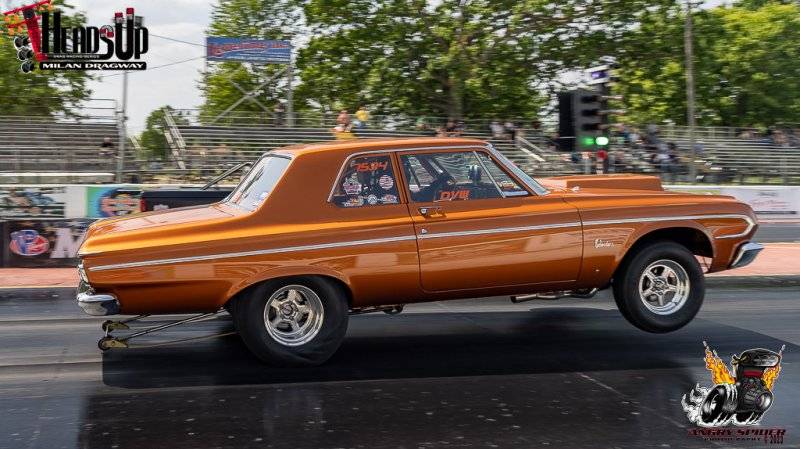

My racecar is sprayed with sunburst orange 802K 2004 GM color code. I think the newer colors pop in the sun much better than the old stuff. Covered well over light grey sealer. Also color matched on touch up as well. New hood was painted 10 years after the car. Matches perfect. Most of the flake is pearl instead of metallic. The painter said it was much easier to spray as the heavy metalic didnt tend to settle in the bottom of the cup.
Doug
