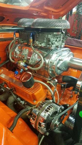

I've used both self etching primer and epoxy primer. Both work. The last 20 years or so we've used epoxy. All of these motors were primed with epoxy and painted in urethene single stage. They have been painted between 13-25 years. They look like the day they were painted. The race motor even has bondo fill in it.

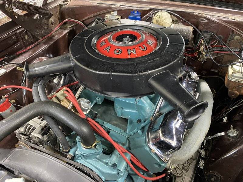

Not a show car by any means. Just looking for a decent look that won’t peel off. I’m using Seymour Chrysler blue rattle cans.
