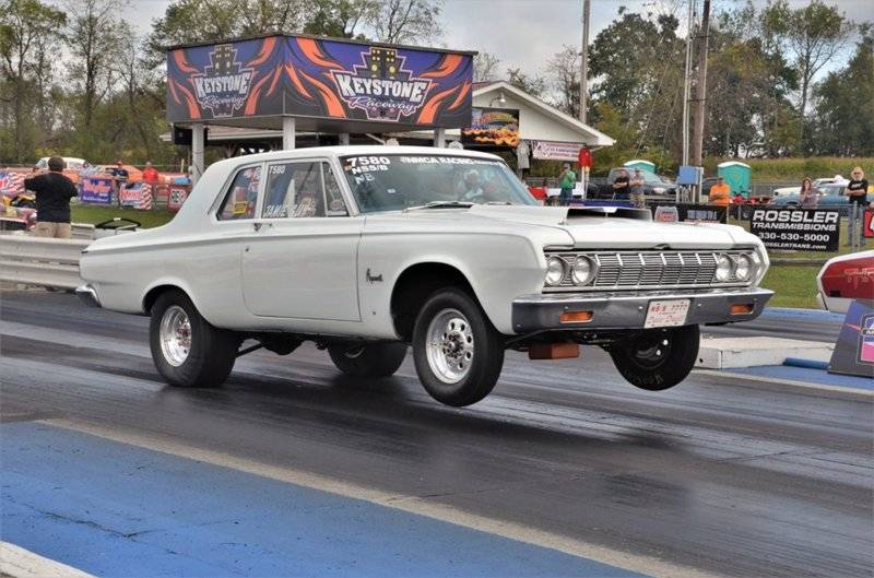

I put the Pro Bracket radials back on last weekend and went to Keystone Raceway Park (Pittsburgh). I had recently purchased a pair of Viking Crusader DA shocks and adjusted them according to Tex013 recomendation, 5 reb and 10 comp. (Thanks Tex) The car worked great 8 out of 10 passes. My 60ft's were between 1.40-1.42. The 2 out of 10 that costed me were 1.50 and 1.45, my fault as I knew the track was going away and should have made an adjustment, on those 2 runs the tires spun at the hit. I am thinking loosen the rebound ?? Any suggestions??
