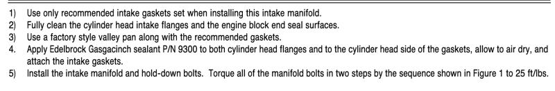

Does anyone care to know what the torque required by the manufacturer to adequately crush the sealing ribs is ??
Performer RPM #7193

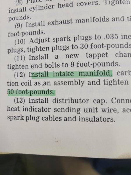

I'd like to know. Aluminum and iron intake?
This is a 66 book. The 72 book shows a reduction of 10 . Don't have a 69 book. What would be the reasoning of reducing torque on an aluminum manifold? Fear of it getting bent?
This is a 66 book. The 72 book shows a reduction of 10 . Don't have a 69 book. What would be the reasoning of reducing torque on an aluminum manifold? Fear of it getting bent? View attachment 1796980
Yeah I wouldn't want to go above Edelbrock's recommended torque on an aluminum manifold. Just softer metal versus cast iron boat anchor.

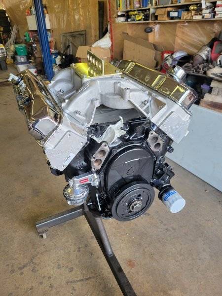

I wasn't gonna weigh in how I did mine to avoid the blah blah blarggagaga about it, but wth...
My 7193 is torqued to 25 ft/lbs on a set of 452 iron heads, using the 1215 valley pan, and a paper gasket on the intake side, but not on the head side, with sealant of course.
No vacuum leaks, sealed just fine. Only bothered with the 1 gasket because I bought into the "don't want to mark up the new intake surface" argument. This is the "Nick's Garage" method that he says to use.
However, Pete from Pete's Garage will use only the valley pan with sealant even on aluminum intake with aluminum head engines. You will get different answers from everyone, claiming to be the expert on the subject.
Both these guys are seasoned engine builders so that's why I say you can do it either way, IMHO.
