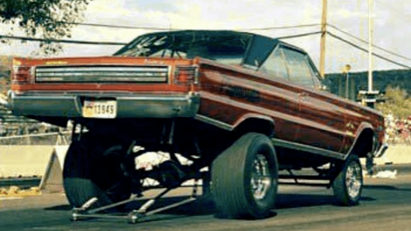

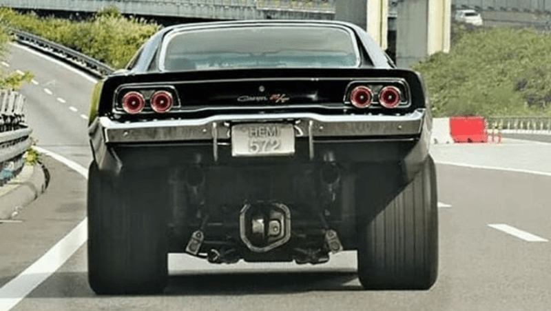

Pics with Eaton 2" lift leaf springs
Hell of a rake got to be difficult to drive
Not really difficult to drive but it does drive very differently. Cornering is totally gone for one and the ride sucks. It also puts a lot more load on the front end....
