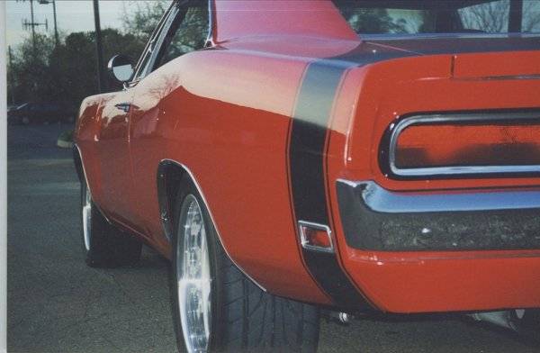

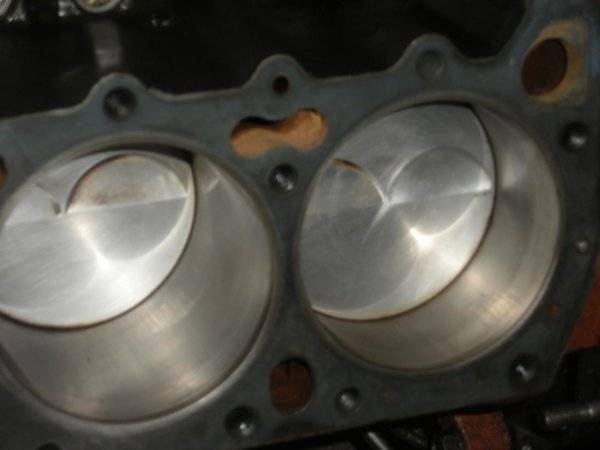

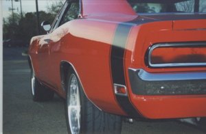

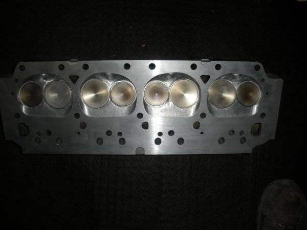

The trick is to shorten the advance curve. Most engines feel more responsive with more base timing than the factory spec. This is partly because many of us build engines a bit hotter than stock. A bigger cam needs MORE base timing. I run 17 degrees at idle, 34 degrees total in my car. My distributor HAD a 28 degree advance that had to be adjusted to a 17 degree curve limit. Again....17 degrees at idle, another 17 degrees is added to arrive at a total of 34 degrees at around 2400 rpms. I'm at 10 to 1 compression and have aluminum heads.
