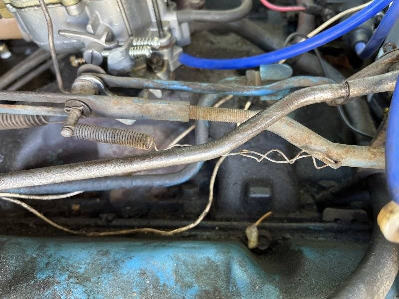

IRONICALLY… or maybe more hilariously, everything is dialed in and I still have a bit of a hesitation on acceleration if I stomp on it (more when warming up) I noticed the accelerator arm is connected to the inner hole up top instead of the outer hole.. just an observation, not saying that’s why… accelerator is a strong stream if I mash on it… so I don’t know, I’ve done everything else that’s been suggested and it just sounds like it’s being flooded and catching up or it’s choked out for a split second and it roars to life. If I feather or slowly depress the accelerator, it’ll be just fine.

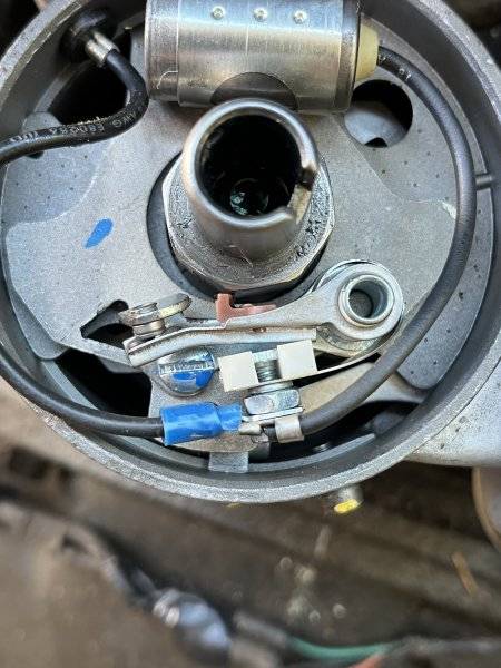

I took the cap off the dizzy and looked inside.. it seems there’s points/condenser and then some sort of plate and the springs underneath. Do I unscrew the nut (the rotor sits on) and then remove the plate? UTG suggests eliminating the heavier spring altogether…

-return the accelerator pump to the factory hole

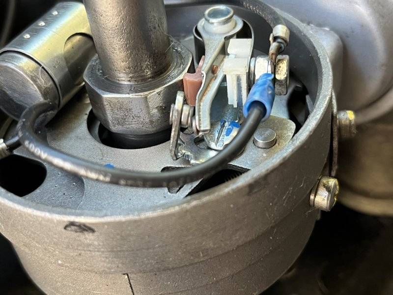

These points don’t look great… should the two points that meet and seperate be lined up?
Never mind, bent them back and gapped to .018… sure lit off a lot quicker… on to the plug gaps hope everyone’s enjoying their Saturday

-I adjusted the point gap to .018, bent it back so they touched square.

-returned the arm of the accelrator pump back to the factory hole
