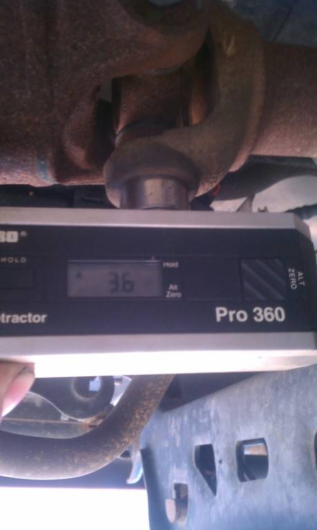

Ok here we have the trans end of the shaft and angle
As you see i take the angle measurement off the joints cap, and we have 3.6 degrees

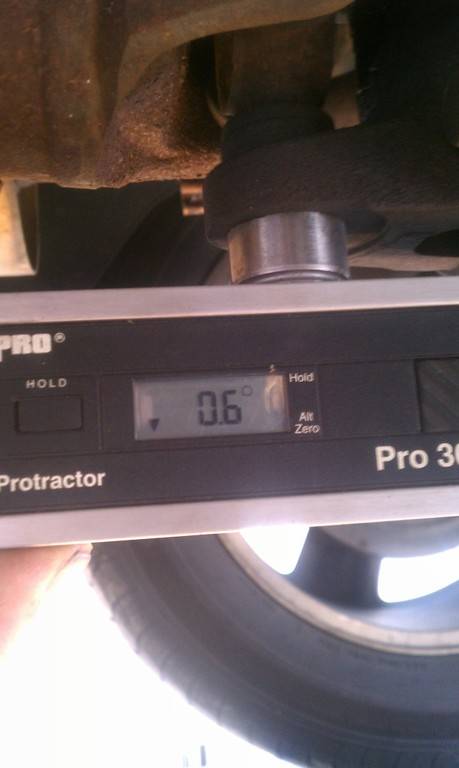

Now to the diff end
We have .6 at the Diff

Now this is at rest as it should be, when the power is applied the diff will rotate up 4 degrees and also change the shafts angle 2 degrees and alleviate the working angle at the front under load.
At rest there is a 6.5 degree diff at the shaft, and 4 degree diff at the working ends
Underload we'll have nearly identical angles between the trans and diff, the slight lift of the housing will change the shaft angle around 1.5 to 2 degrees making it a 4 degree slope, alleviating the working angle also.
