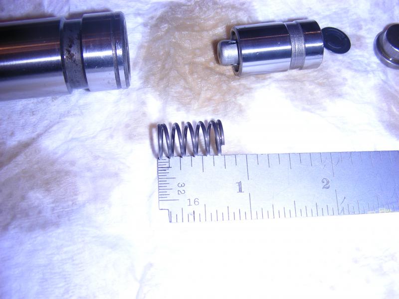

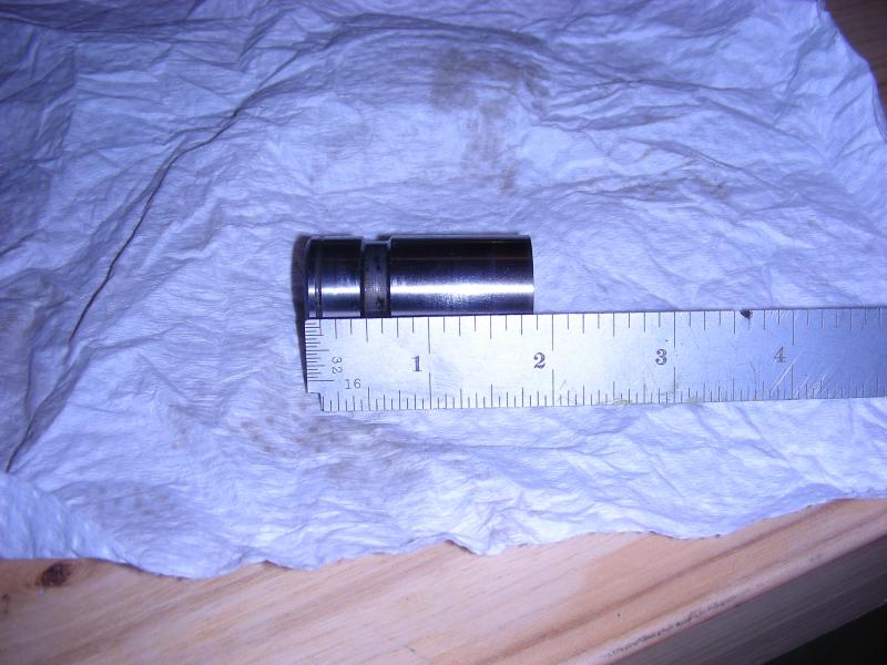

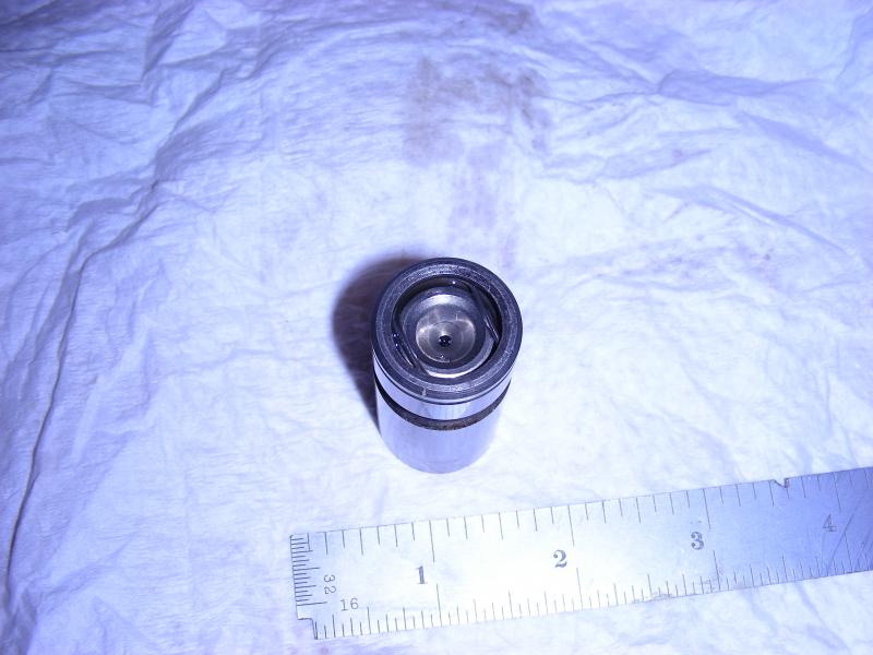

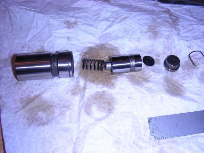

DSCN7758.jpgDSCN7757.jpgDSCN7755.jpgDSCN7756.jpg I got the time to pull one today and tear it apart, everything looked good. Before I tore them apart I measured how far down you could depress the lifter before it got stiff ".067". Once I tore it apart and cleaned the oil out of it it returned to being firm all the way to the top (the oil in it was what wasn't allowing it to come back to full stroke "something is jacked with these things". I also talked to Comp today "not allot of help" they basically covered all the same bases that we have and then told me to send them to them so they could look at them, but I did ask about the earlier lifter and they claim that they only make one style. Does anyone have a lifter to compare to this?
There'll likely be no difference in the lifter body. Where the difference will be is where the pushrod plunger sits. The plunger for the early lifters sits down farther than the later ones. That Comp guy is a dumbass. They make both lifters. They are on Summit.
They do in fact have two different lifter seat heights...... But,,, there is a difference in some overall lifter bodies as well.. The Mopar Performance lifters are allot different than the Hughes EDM oil face lifters....

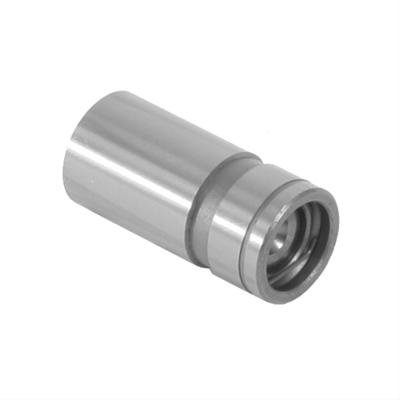

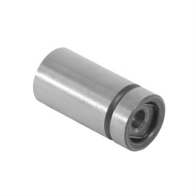

CCA-824-1.jpgCCA-822-1.jpgIt's seems to be all of them and I think I found the problem, I got on Summits sight and started looking at the different high energy lifters and guess what lifter mine looks exactly like "SMALL BLOCK MOPAR" I checked and they have the same lifter bore. The small block ones have the wide oil groove and the narrow groove at the top like mine and the bb lifter has one groove that looks to be higher on the lifter. The one on the left is what I'm supposed to have but mine looks like the one on the right hmmmm. I hope this is it
I see a top and bottom lifter not left and right. Anyway, the bottom lifter has the plunger much deeper. If those are the lifters you have and you have the later (shorter) pushrods, there could be your trouble.
I'm really confused now, now I'm seeing that the small block ones are the same as the big block "what the hell".
Look dude. This is real easy to narrow down. Call Summit. Order ONE lifter for a 68 and UP 440 and compare where the pushrod cup is in that lifter to yours. If you have to, take it to the machine shop and get someone to put some calipers on them and take a direct measurement. Calipers can get down into the pushrod cup and mesaure the static height of the lifters. If yours that came out of the engine is shorter in that measurement than the new lifter, there is your problem.
