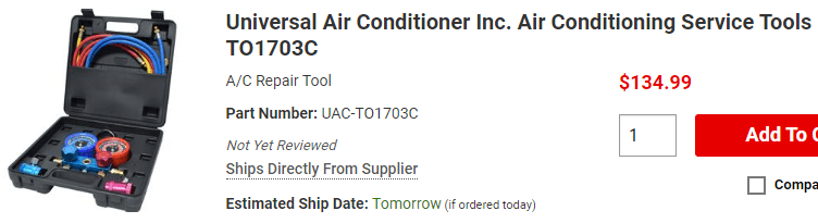

Mastercool (89660-PRO5) R134a Manifold Gauge Set , Blue ($107.60)

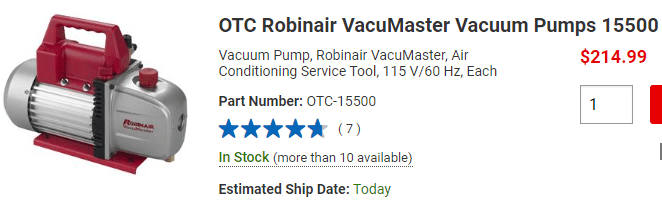

Dedicated vacuum gauge that reads in microns is a must. That pump will give you the deep vacuum you need but a dedicated gauge is the only thing that can confirm microns. The compound gauge on the low side of the gauge set confirms that a system is in vacuum, but does not read accurately enough in the low ranges that you need to confirm that all noncondensibles have been removed from the system.
I do that by shutting off the gauges and letting it sit for 5 or 10 minutes, if the gauge moves towards zero, I pull it down more and repeat until vac holds. I know it's not 'precise' but it works. Your way is a neat alternative but I do so little ac work I can't justify it.

First, I need a good set of gauges. Something like this? I like that it has a case to keep it neat and tidy when I don't use it.
Then, I guess I need a vacuum pump. Like this?
