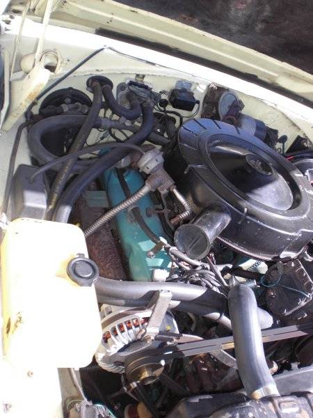

I hope the pic shows up!!! My Charger was delivered to S. A. Camp motors in Bakersfield California and on the build sheet it says "cleaner air package" and meets CA emissions.
I have owned the car for 44 plus years and still need to identify the equipment seen in the pic. I have seen other "CAP" systems with the green cone / spring and vacuum lines. This pic shows the majority of the parts of this system? running to exhaust manifold and to valve cover and to base of Carb also has a rectangular box on the fender that says
"Dana" P C Div with vacuum hook ups.
Any help would be greatly appreciated.
Will
I can’t answer your question but that’s some weird looking stuff you have hung on your engine. I’m doubtful that it is OEM, even for CAP, but I don’t know for sure. Curious to see what others say.
I hope someone from the west coast has seen this before! Midwest and east coast are clueless . If not OEM they drilled the cast iron exhaust manifold ! and did a nice job also on valve cover. No one in 44years has an answer ?? One Guy said he has taken them off of cars while parting them out. but no part ### Tech info or any 100% what it is???

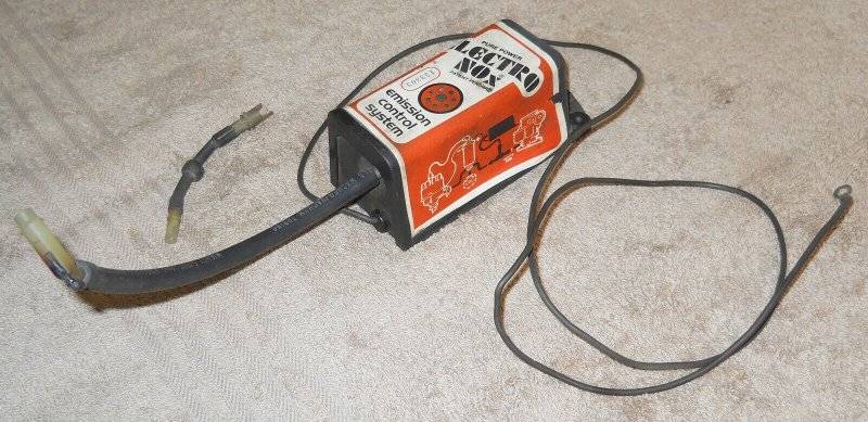

All the stuff marked in red is aftermarket. There were a lot of aftermarket add on emission stuff sold in the mid 70's to get cars to pass smog.
He's some other aftermarket emission stuff you find added onto California cars to get them to pass smog.

Not OEM as stated. Also for the comment about 66 Hemi. CA gave Mopar and exception in 66 for CAP. 66 Hemi were not emission cars with no add on stuff, unless a dealer decided to add it.

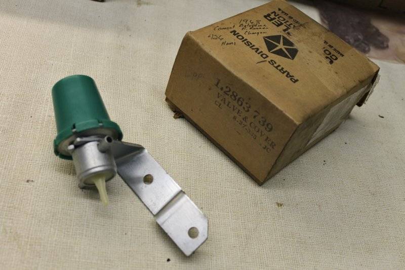

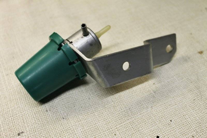

67 was the first year hemi became CAP. 68 all hemi (and all other engines) became CAP for all 50 states. Only 68 and 69 Hemi had the distributor emission valve. It never retarded ignition, just made a choice between Intake and ported carb vacuum depending on which was higher. This advanced timing.
I’m pretty sure the green CAP valve is the same as used on other engines.
I think the bracket is Hemi specific. Is that correct @Dragon Slayer ?
I believe the valves were similar, but the hemi had the metal exit tube which was larger. The other cars and the add on kit mopar sold was a plastic exit tube. Bracket was definitely Hemi only. I am not 100 % on this, but believe that is correct.

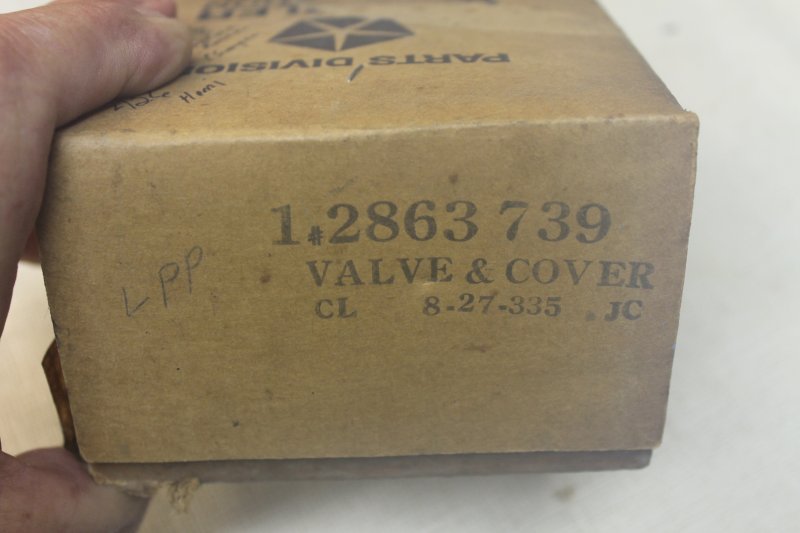

Hey all, Here is what the factory 1968-1969 426 HEMI CAP emission control valve looks like. Kocan

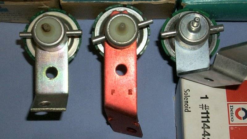

I have had green and blue NOx reduction valves on a few cars. There are a few cars that had remnants of aftermarket vacuum advance control systems to reduce NOx emissions.
Typically, as stated above, these systems are setup to eseentially disable the vac advance until the car warms up. To top off the this ingenuous idea the OEM dictated that base timing be retarded as well.
i had a '66 Belvedere II convertible parts car that moved from NJ to So. CA sometime in the early 70's. It was fitted with a funny looking aftermarket vac control that was unlike the OEM units shown above.

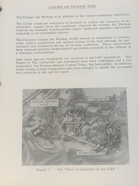

Just happen to go by this document telling which 1966 California cars got CAP
Steve.. Thanx for posting that document confirming the 66 426 Hemi did have the CAP package. I bought my Belvedere II Hemi new from McPeek Plymouth in Anaheim, now his son has the Dodge dealer in Tustin. After taking delivery and having starting problems with the car being new I went back to McPeek for a closer check but apparently their tune-up tech didn't know what to do. I went home pulled off the control valve and took my distributor to Louie Unser's shop in Fullerton for recurving, after reinstalling never had any further starting issues.
Just my $0.02... :thumbsup:

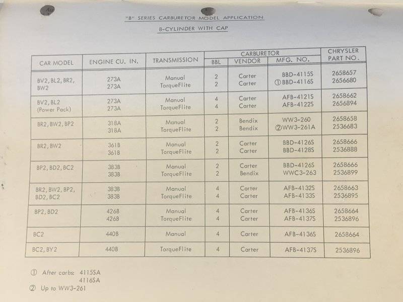

That caught my eye too. But actually it lists the 426 4bbl and 440 4bbl.
I would think the Hemi would be listed 426 8bbl ?

The owner since 1969 of my 1966 Hemi sold new in SoCal was the one that had that document in his archives.
I’ve got records of smogs until 1995. Mostly done at a place called Don and Harold’s in Long Beach. One time even had to go to a referee.
