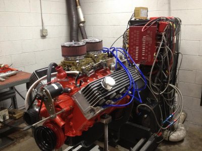

My '64 330 with a stock 2bbl 100K+ miles Poly went 130 mph on the freeway - no slouch. There is some guy who specializes in performance Poly's and he gets 500+ HP out of 'em, keep in mind - nobody makes aftermarket heads for 'em! - google it and see for yourself. If I had the money I'd build a tricked out POLY for the Engine Masters Competition and blow some minds...

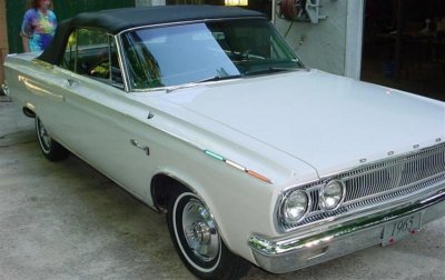

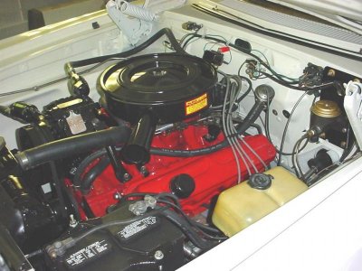

My first Mopar was a 62 Fury with a 318 poly bought in 64, I've been a big fan of the poly since then.
I've owned several big blocks, 383's, 440's, 6bbl's, and Hemi's. Loved them too....
But now I'm back in a 318 poly... pulling down 17-20 MPG on regular pump gas, and having more fun then ever....
