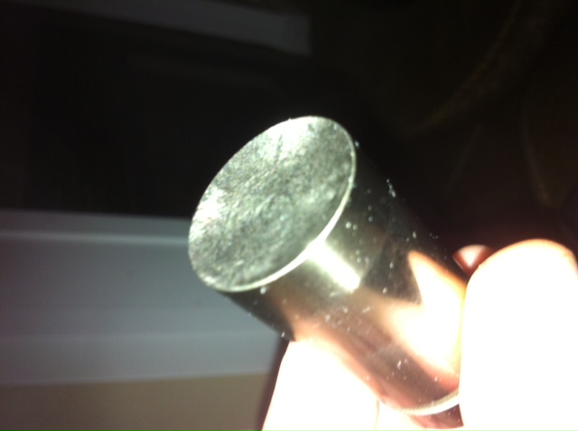

Here is a picture of the lifter from the rocker without movement, its about 1/8 inch concave, Im assuming this isn't a good thing. I cant just replace the offending lifter correct?
If I need a new cam for the 440, what else should I replace while Im in there?
Timing chain? Valve springs, I'm thinking about the MP 509 cam.

did you just perform an oil change about the same time you swapped carbs around?
No, but It did have the occasional tick.So Im really not surprised, I guess the carb was just coincidence, or my test and tune was the last straw.
Anyhow,,, todays oil will cause this very thing,,,, Happened to me too!
Only problem is that you now have all the metal that's missing shoved in all kinds of bad spots! I had to tear mine down, Inspect bearings, and clean it all out then re-assemble. I ended up pumping about 4 gallons of Kerosene through the oil passages with a new filter stuck on the pump to make sure all of it was out! then I ran some cheap oil through to get all the Kerosene out!
Make sure you use some good oil and get the RPM up right away to make those lifters spin during breakin,,,,,,, Brad Penn is what I went to and worked great!
Maybe consider a total rebuild to match that big of a cam. Get head work done and compression and intake to match. Otherwise just replace like for like would be my opinion.
After seeing the lifter I know this isn't the problem BUT if you're running a points dist. you could very well be seeing points "bounce" @ high rpm. Used to be a common problem back in the day with cheap parts. Seen more than 1 car with vacuum tubing behind points to cure it.
We just pulled out my buddies lifter from the same exact hole and it looked the same. 300 miles on a brand new rebuild..... replaced the one lifter and within 10 miles it did the same thing. We pulled the cam out today and that lobe is toast. If you replace that one lifter it will most likely do the same thing.
