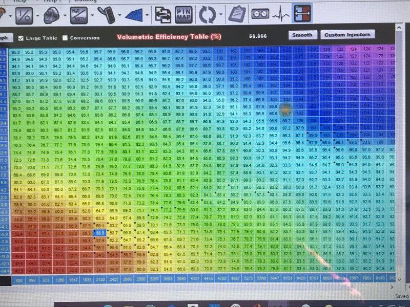

The best solution is EFI with programmable everything and data acquisition, but everyone’s definition of best differs as much as the problem being solved.
I am currently installing hyperspark to go with my sniper EFI, only needs MAP sensor. :fool:
