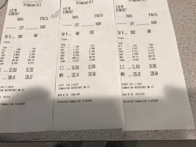

THAT THING SHOULD FLY !!
You need that 4.10 gear more timing and it's an easy 9 sec car, your combo should go 9'60's at least when sorted. Do you use an A/F gauge ?
agree. so far only one test pass.
here are wednesday night time slips.
