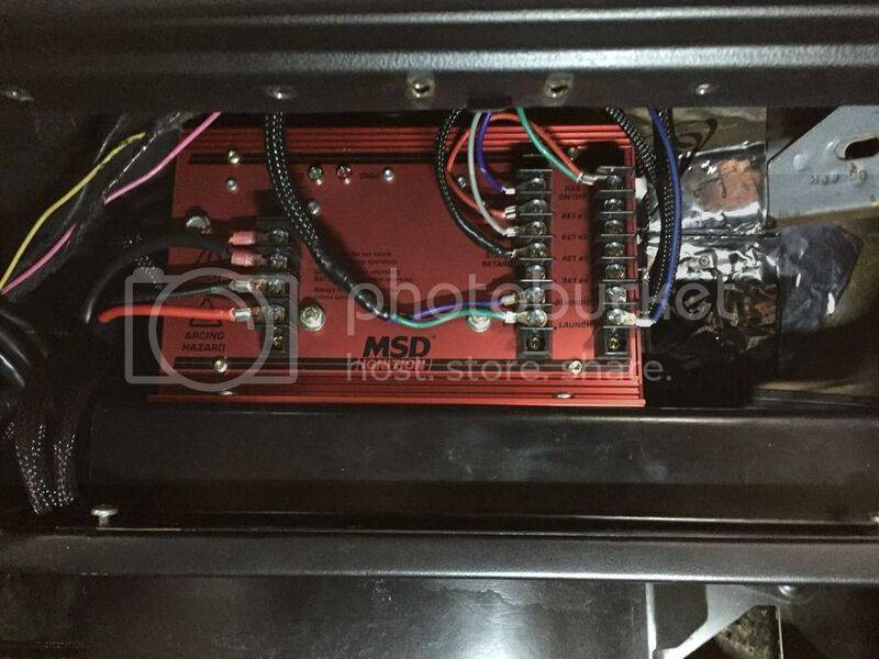

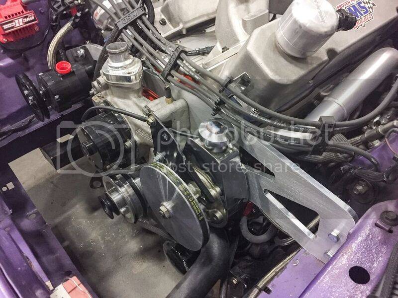

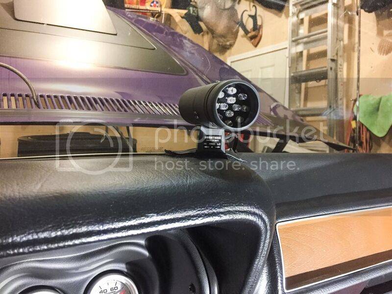

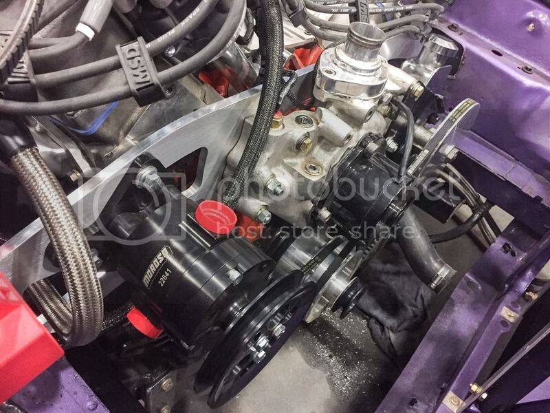

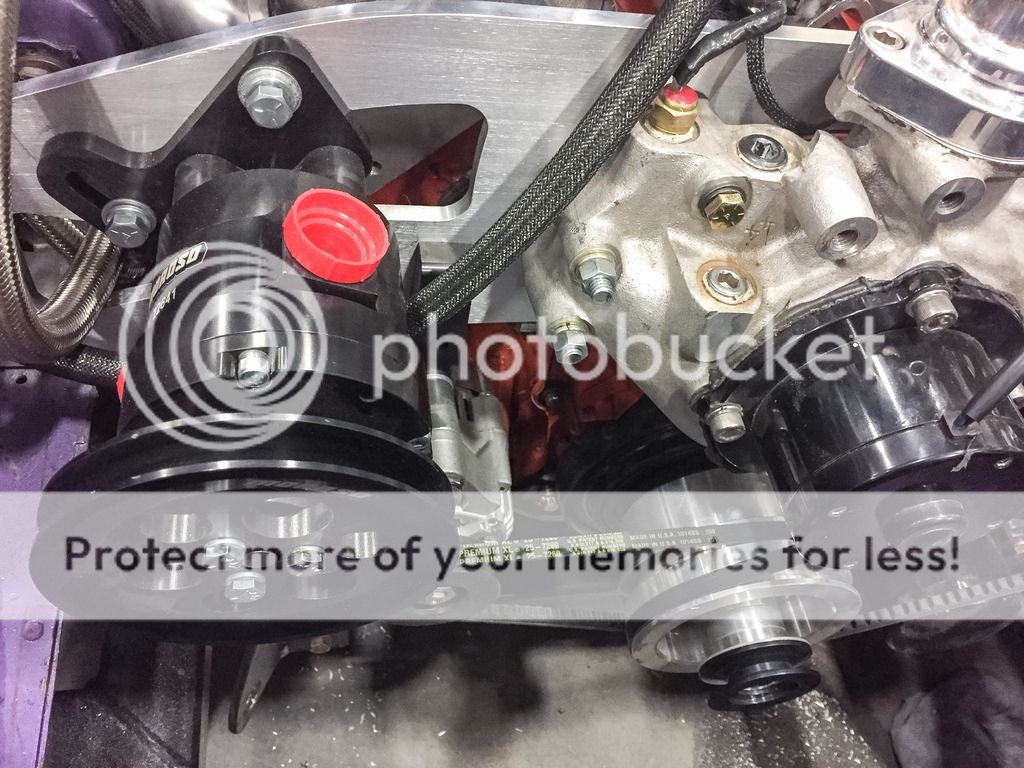

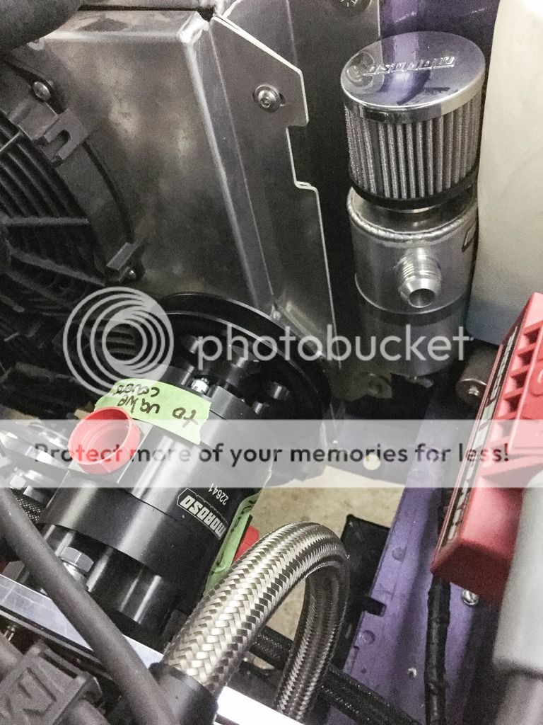

Installed a new shift light and an MSD 7AL3. Putting the finishing touches on the motorplate and vac pump setup. Also built an air pan to seal to the hood. Still have more testing to do with it. So far it seems to make things worse, but I haven't had enough track time to confirm that.
Nice workmanship. Thanks for the great pics. Dave

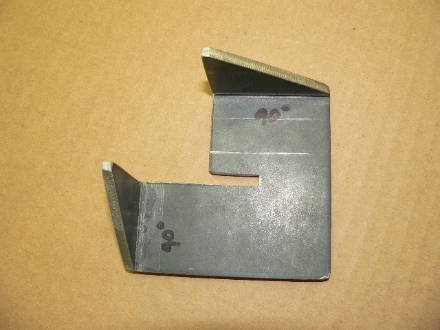

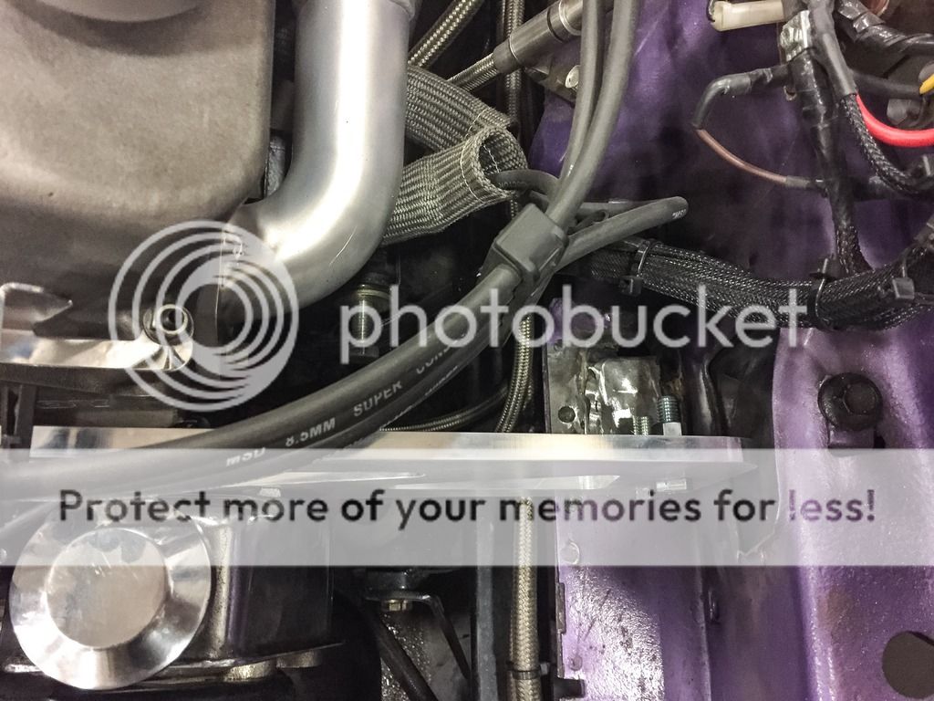

PLEASE Show us some pictures of the angle brackets that you bolted/welded to the frame to attach the motor plate to.
Also....did you merely jack up the motor, remove the stock motor mounts (if so, was there room to remove the stock motor mounts by merely jacking up the motor ?), bolt the motor plate to the front of the block, put the water pump back on, then lower the motor back down and let the motor plate rest on the frame rails and then attached the angle brackets...or what ?? Please let us know you procedure because I need to put a motor plate on mine.

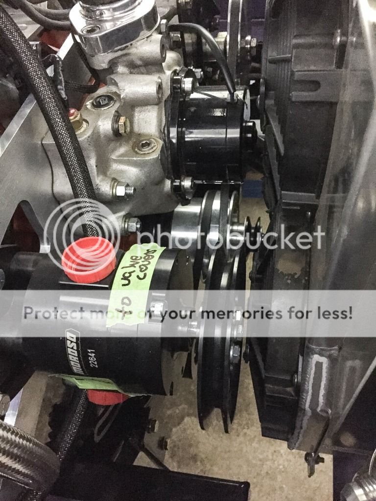

Also, I see no water pump belt drive or alternator. How do you pump the water and do you not run an alternator ?

Have yet to see if gaskets will leak. I actually installed plate with mounts on, so if I ever decide to go back to stock I can. I have an Alterkation front end so mine is a bit different than the stock setup. I will post the angle bracket shortly. It is an AR Engineering product as well that goes with the plate.
Alternatoris below plate. It is a small race alternator. AR Engineering has a kit for the alternator that works with this plate. I run an electric W/P.

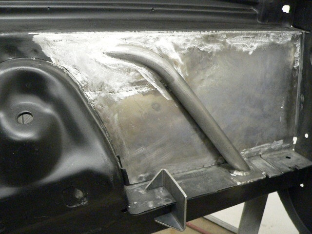

I love the Wookie mobile. One of my favorite body styles. And I agree, nice workmanship. For what it's worth a couple shots of my mounts.

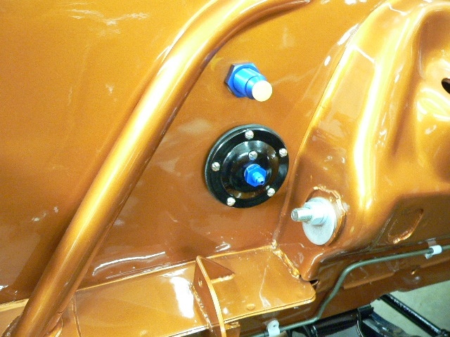

Is that your coil insert coming thru the fender well and what is the other gizmo ? Looks interesting...let us know...pictures from the rear backside maybe...love it. thanks
The blue fitting is the fuel line bulkhead. The black item is the fuel pressure isolator for the fuel presource gauge. It's sunk into the fender well instead of being mounted on a bracket.

Doug, do you run anything to limit the for/aft movement of the engine besides the motor plate and trans mount?
