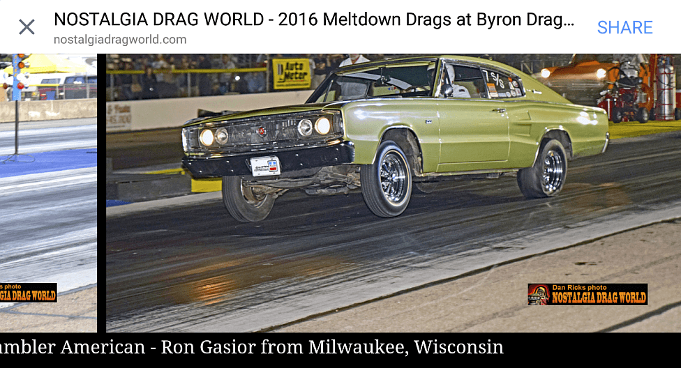

Was contemplating going with 4.10s or 4.30s and a 29 or 30" tall tire... Right now I'm 325/50/15 (28") with 3.90s...... Or I would keep the tire size I have and go 4.10

I'm going to do convo pros or hole shots , no rollbar , & strange adjustable in front / comp drag adjustable in rear . . That slip I posted was launching at 27 usually I launch 45... what should my 60' look like ?
Also the shop that's doing my frame connectors told me to try launching off idle to shock convertor ? ... can't see that doing better than launching at high rpm

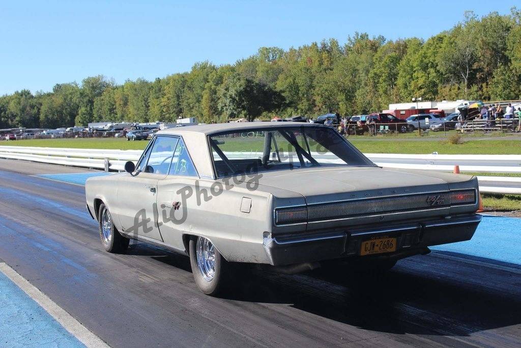

Taking a similar combo to a Test and Tune tomorrow at Atco, NJ. 496" Stealth CNC, 4.30's, 3800 converter, M & H 275-60-15 Stickies, SS Springs. 6BBL Auto, through 3" Flowmaster exhaust. 69 RR @ 3750#.
View attachment 374722 Ran 11.62 @115 first time out. 30 degrees timing (don't ask...I'm an idiot) wouldn't run more than 115 mph, but ran the best 60' ever at 1.52!! Hoping to turn it up to 38 degrees and run some sub-11.50's. Will let you know.

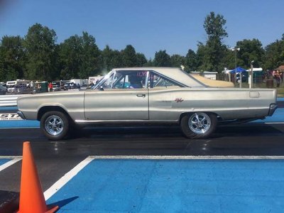

505 BBM
4.35 bore
4.25 stroke
6.8 Rod
11.0 compression, dished piston
Eddy RPM heads, std port
Indy 2D
1000 AED 4150
93 octane pump gas
33-34* total
2” primary, 3.5" collector
3” muffler, 3” full exhaust
3.54 gear-Dana 60
727 Transmission
2.75 first gear
8” Dynamic convertor
9x28 M/T Pro Bracket Radial
Footbrake car
Street/strip
Weekly bracket race
Spring and fall is 11.25-11.30's@118-119
Summer is 11.32-11.37@117-118
Sixty foot is 1.57-1.61
4 corner scale is 3,950
Trap rpm is 6,000-6,100

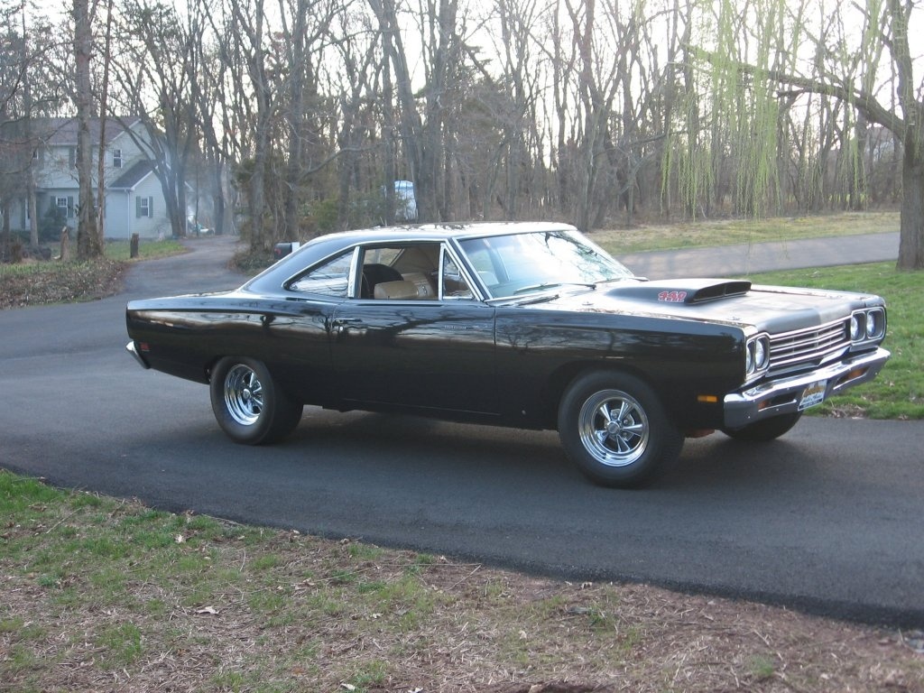

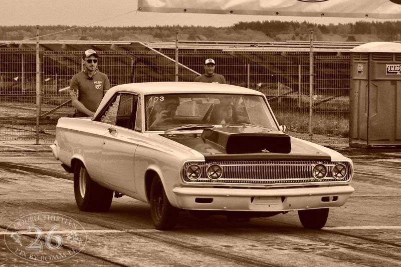

Well, after introducing in the "Welcome Wagon" want to talk about my 65 coro

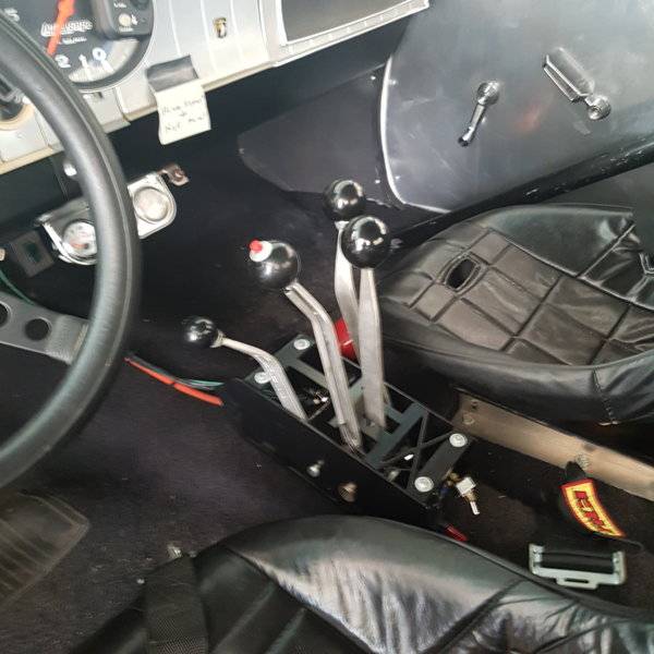

with the old shifter
new shift-kit installed

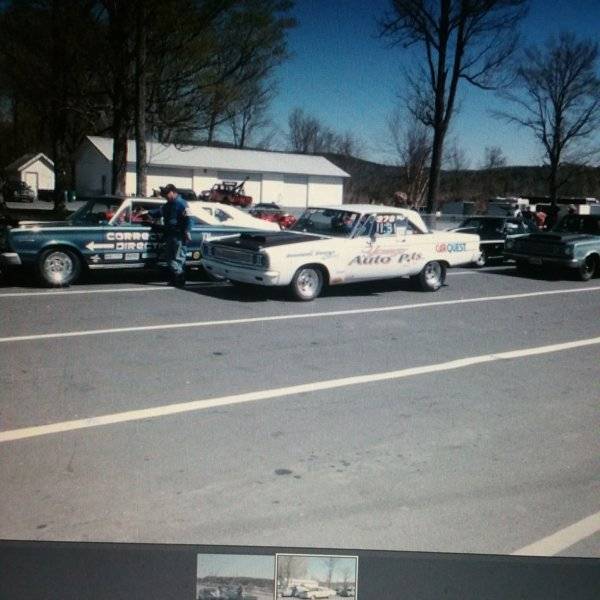

and 2old pics from his long time in america, where the car was build in 1997
+ one of running raceplaces
bought the car in the middle of 2016 from a german friend...we races in the last year only 1/8mile cause there were not so much 1/4 races
Best Time in 1/8mile was a 6.8...this year we will going in to rock the 1/4mile
Know for shure a 11.31 at 1/4mile from the coro in Amerika
we made only new: bigger hoodscoop from fibre and mounted an new shiftkit fro better handling, old one was also very rickety
some technical facts:
engine: 416cui, 71-40 over 340, diamond pistons 9.7-to-1 compression, sir rods-eagle-speed pro moly rings, crank-eagle-stroked, melling hi-volume oil pump, 7quart moroso oil pan, moroso windage tray, mopar 590 solid cam, isky modular iron rockers, crane push rods, edelbrock performer aluminium heads, carb:750-hp-holley-80jets-4-corners, trans: 727 with transbrake, turbo action sprag + aluminium drum, deep pan + pickup, rear: dana 60 457 pro gear, stock axles + carrier, 90-10 front shocks, long travel rear shocks, cal trac style bars, frame is tied, ingn.-MSD,
Fuel system: 2-holley blue pumps 3/8 lines into y-block-1/2 inch aluminium line to regulator-6an lines to carb
it´s a nice little monster for me, i have some cars... but never had a car like this!!! with impressive mopar-power
I hope we have a lot of fun at the 1/8 and 1/4 strip this year
Maybe one of you knows the car and his former owner from times at north-american raceplaces and have some further informations about the car-history...i love it if cars have soul and history
I´m shure that the "Superstockracer" Chris Baum was racing against him
Greetings Winki
