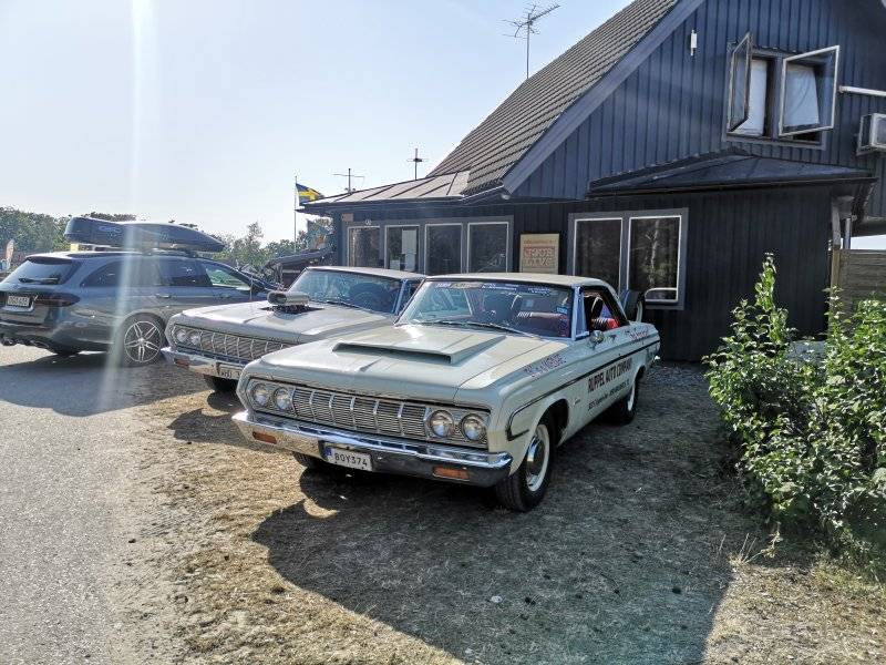

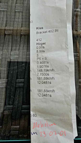

Update.
Had the opportunity to test the new torque converter.
110mph with old hughes 11" 3000rpm tq
114mph with new custom made 9.5"
Really bad track, my best 60 foot was 1.9076 sec.
I've been 1.68 on a prepped track.
On a good track I believe the car can go 11.6- 11.7s
440 cui
L2355 pistons
Cast crank, ly rods
Howards 250/254 dur 0.588/0.600 lift flat tappat cam
E-street heads
Stock interior, steel body 64 belvedere
727, 3.73 rear
First time at a real track in 50yrs.

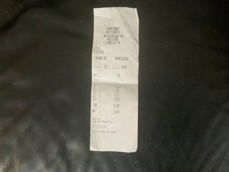

68 RR 383 stroked to 450cu. CNC stealth heads, 1 7/8 TTI headers full exhaust, 410 rear, quick fuel 830 black diamond carb
Last run of day was 12.48 at 117.4 MPH
Came at of the hole at 3,000rpm running P295/55/r15 Hoosiers
My friend was running 12.64 - 12.8 at 105mph
12.4 @ 117 sound right?
Note only power shifted second and fourth speed shifted third
My daughter runs about exactly what you're friend does, well setup bracket car.
Your numbers can be traced directly back to your transmission. Like mentioned should be mid- high 11s. Getting a 4 speed to lay down automatic #s will be a challenge.
Can you post your other time slips. Something looks odd to me.
Also forgot to mention I’m running a dual plane intake edelbrock performer rpm which I thought should be better at low end not top end
You have plenty of power NOW, to run elevens. Your 89 and change 1/8mph shows that too, just like your 1/4 mi mph. 90 mph can be an easy 7.80 eighth.
Youre trying to find e.t. on the wrong end of the car.
Since you are a stick, my number one recommendation would be a set of real slicks, and hope you don't find the weak point in your drivetrain.
You might be tempted to try a drag radial, but they are not recommended for stick cars. DR'S don't like to spin, if they do, you have to back off the throttle to get them hooked up. Real slicks can work with some wheelspin, and still give good results.
If you can get that 1.9++ 60ft down to a mid 1.7, I think you can get 2 or 3 tenths to 660, and maybe 4 to5 in 1320. (And this estimate might be conservative)

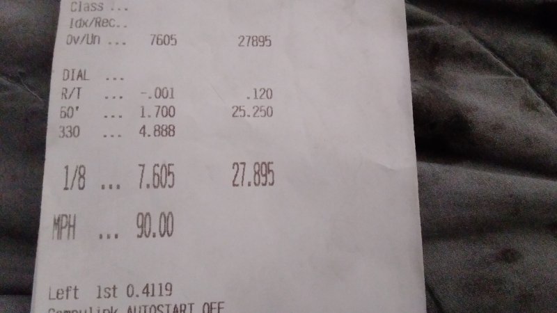

Here is one of my old times lips, 1/8 mi, 90 mph.
(440, iron heads, 727 with a good converter, 3.91 gears, and slicks)
Your 330 to 660 is 2.77, mine is 2.72, very minimally faster. You are slow to 330 by a half second. THAT'S where you will find improvement, not shift speed or uncorking exhaust.
