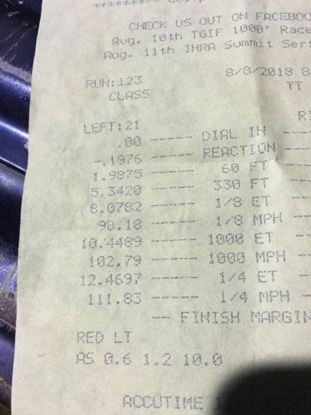

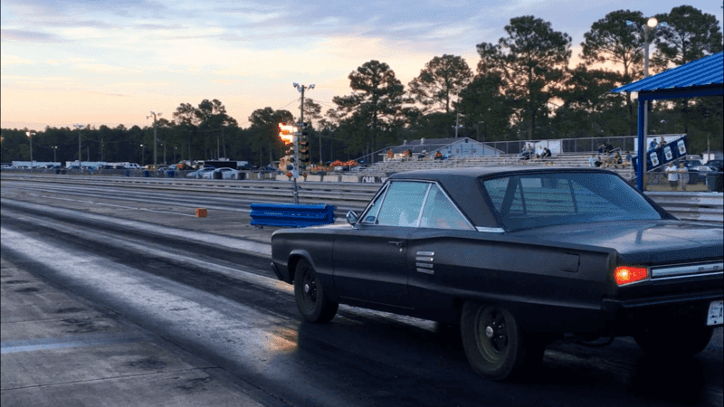

Results of my fist time ever taking a car down the drag strip. Still trying to learn how to 60' the car. Hoping for lower 12s with the current combination. Car could definitely use more rear gear. Drove half an hour to the track on 93, raced, and drove home no problems. Happy with the result for first time out!
Full weight 1966 Dodge Coronet
500 cubic in 440 stroker
Weiand tunnel ram
Dual Holley 600 carbs
906 Cast iron cylinder heads
Hooker long tube headers
Full 3" exhaust with Flowmaster mufflers
727 Trans with reverse manual valve body
8 3/4 Sure Grip with 3.23 gears
275 60/r15 Nitto nt555r drag radial
Best E.T.: 12.46
Best mph: 111.83
View attachment 636132 View attachment 636137 timeslipfirstnightout8_8_18.jpg startingline8_8_18.png

I would put a set of 3.55 rear gears in.
Much more than that you wont be highway friendly. With 4.10 in my car I'm running 3200 RPM @ 55 MPH with the same size tire. Luckily my car is stored less than a mile from the strip.
With the stock 3.54 gears I had in my Dana 60 I used to turn 3,500 at 75 mph.
Still had room in 4th through the 1320 with a 6,200 RPM redline, but was "into" 4th far enough before the finish line so it wasn't a problem.
After I installed my Passon Performance a855 5 speed w/the .70 5th gear I went with 4.10 ring and pinion gears. Now I turn 2,750 at 75 and hit 4th before the 1/8th mile but don't hit redline before the finish line in 4th gear. Best of both worlds.
Since I spend most of my time driving outside of track days, I would have stayed with the 3.54 gears if not for the 5 speed.

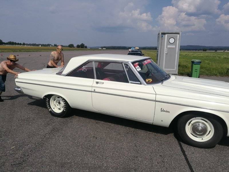

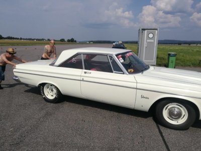

Circa 1991-1993
1968 Plymouth Satellite
Re-ringed std bore 1968 440, 346 heads with a NAPA type valve job and a set of decent springs. Crower 271Hdp cam, stock rockers. Original Torker with a 780vs Holley and 1” open spacer, 1-3/4” headers, moroso underdrive pulley.
3570lb race weight, full interior, factory 11” converter, 4.10’s, 10.5x29.5 bias slicks, old SS springs(installed in 1984).
60’ in the 1.70’s, best run 12.12@112.
Prior to that I had a std Performer on the motor and a stock lower pulley.
That ran consistent 12.40’s@110.
Shifted it at 5K, and it went through the lights at about 53-5400.
I ran it one time with the street tires on the back, which were tractionless hockey pucks(Dean brand “Stinger” L60-15’s), which I got to go like 12.80’s feathering it off the line.
Only went about 107 with the shorter tires....... motor wouldn’t really pull past 5500.
