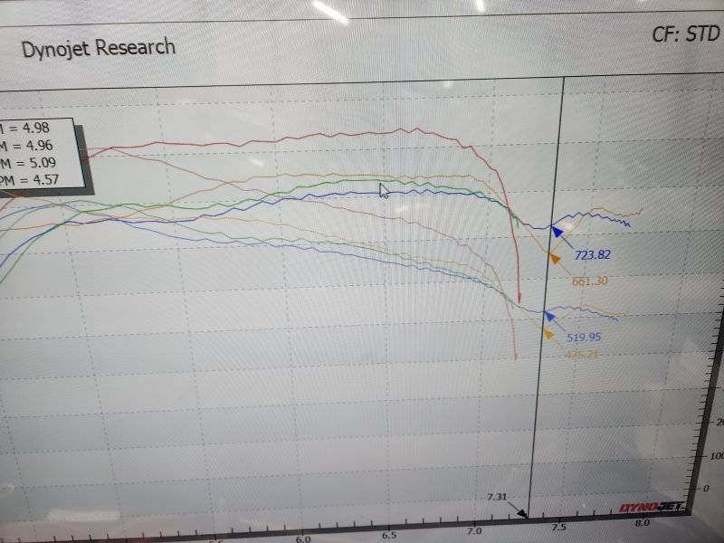

Nothing losing power. I’m only at 17psi on those runs. I think it’ll go 170 in the quarter when it’s turned up.
Reason I asked is mine was losing power, figured out the issue now, can't wait to try it out.
What did you find?
Replacing valve springs. Then back on the dyno, believe that's the fix.
As you can see, at 19 psi it loses 500 hp from 6700 to 7200, but at 15 psi it just dips, then recovers, and only makes 90 less hp. So I believe the cut rate springs I used are the culprit. Car felt like someone covered the turbo inlet at 900 ft.
I'll update ya when I make the swap and get back on the dyno. Thanks.for asking.

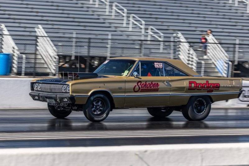

I've been waiting to post to this thread since I joined this forum back when I bought the car haha.
67 Coronet, 505 BBM, Trick Flow 270s, 1050 Dominator, 13:1 Compression, Off the shelf Solid Flat Tappet, 10.5 radials. Weighs 3421 with me in it.
Best run to date is 1.370 60 ft; 9.70 1/4 mile @ 136 MPH. Nice to finally be in the 9 second club :thumbsup:
