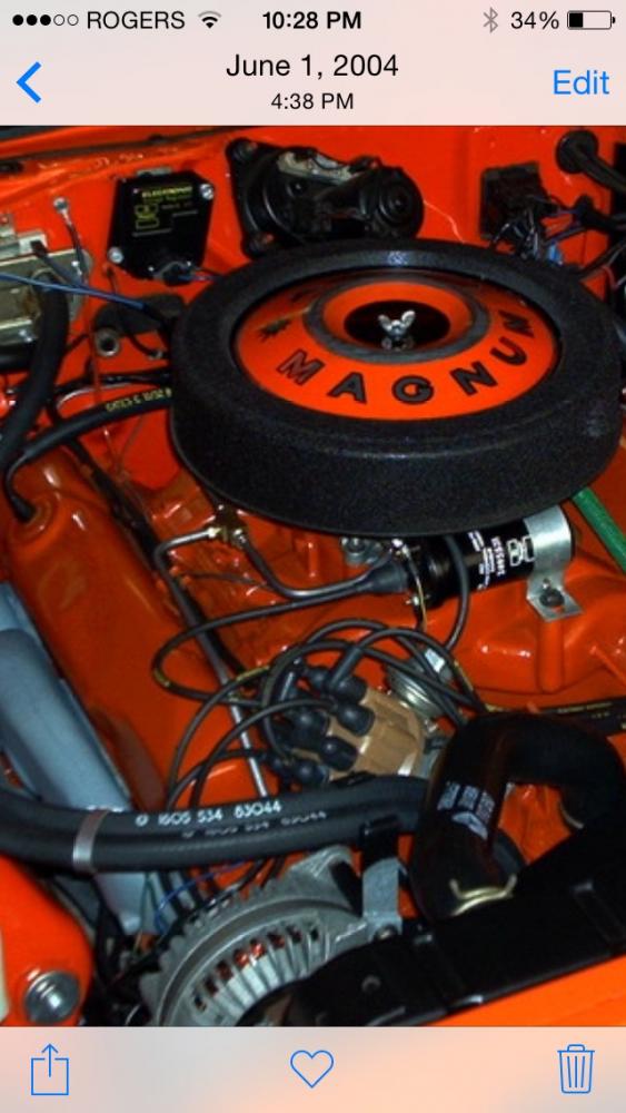

Where can i find pre bent fuel line for my 440 like the one in the picture. Really looks awsome and clean image.jpg
That looks like it was made, most "pre" done are all one solid piece. Dont be scared to make your own, the tool to bend is the most expensive part, and a flair tool will make those lines nice and tight without leaking. Took me at 22 with no experience a total of 30 mins to make mine very similar to that.
That is right. The tubing bender is a great thing.
I make my own fuel lines in every build. You can get lines with fittings on them in many lengths at the auto parts store. They call them "Brake lines". I often get a 30" or a 40" so I can cut off the excess and use it elsewere.
