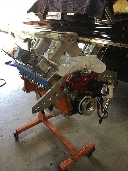

pre oiling top end of 440 motor
Timing mark on balancer. I see you don’t have the balancer on in the photo
its on, thats the only rocker pic i have..this is it right now. o.k. i will start there tomorrow. i guess worse scenario is pop off the rocker assemblys, pull up lifters and leave in the valley, and pull cam out and eyeball that bearing. . by unbolting the cam gear it comes right out with no further dissassembly.. thanks.

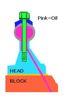

I'd pull off the rockers and poke a wire down the oil hole. Could be the head gasket has no oil hole, cam bearing installed wrong.
did that, wire goes all the way down,i will rotate it some more tomorrow and if it comes to it, pull the cam out and look at the bearing, fairly easy with the full cover gear drive,just a few bolts . but i hope not, motor was going back in on thursday..
Is the rocker shaft around the wrong way? I remember something about that somewhere??
I have done this before, and I think it still gets oil up top, just doesn't distribute quite right.
Not 100% sure though.
I've never had to put any effort into getting oil to the top, crank it slowly while priming the pump.. that's all it takes. As has been mentioned try it with the shafts off just to eliminate that possibility. I've never had to investigate as mine always oiled but the wire trick sounds logical provided the passage doesn't have sharp turns or overlapping bores to prevent the wire from feeding freely? If it passes freely I would think you could take note of the depth at which it stops and determine if it's the head gasket or cam bearing?

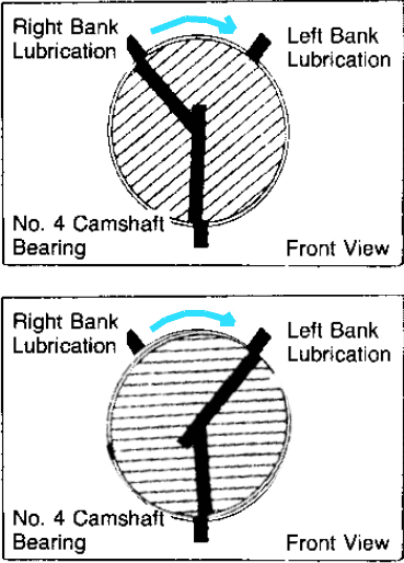

#6 TDC oils one side and #8 TDC oils the other.

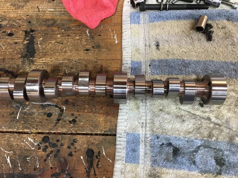

found the problem...Crane did not drill the cam for rocker oiling ! bearings r perfectly aligned. but the wire stopped at the solid cam journal...after 2 years now i get to deal with crane. summit says they have a 1 year parts warranty,,i hope the lack of holes in there New cam sways them..
Just machine a shallow groove in the cam journal that aligns with the hole in the cam bearing. I made one easily with the lathe. Don't make it to wide or deep.

I’d probably have it drilled with carbide or conventional EDM. Who wants to mess around with a restrictor? Of course a replacement cam would be best.
I read about grooving the journals for continuous oiling in a book by Larry Shepard.
The guy seems to know his stuff.
I put far less of a groove in mine than he suggests you can in the book and have no excess oil problems. The groove I put in is 20 thousands wide and 10 thousands deep.
The camshaft has the standard holes plus the small groove.
I decided too go continuous oiling as I have Hughes rockers and wanted to be sure they were adequately lubricated.
