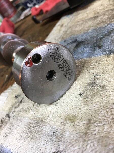

pre oiling top end of 440 motor
crane cams went out of business a year ago !! hows that for a giant F.U. and i'm left holding a non finished cam. calls r being redirected to lunati who said they wont touch the cam as far as adding the oiling holes. cant blame them. summit ended up giving me what discount they could on a replacement from howards. anyone want a new cam almost done ! half price !

If you been rotating the crank and have no oil up top then there is a problem.
Put on #1 compression stroke, rotate 1/4 turn clockwise. Now it will be Oiling left side. Turn 3/4 turn clockwise to timing mark. Now oiling right side. Now on #6 compression stroke. Engine is 180 degrees off so install distributor to #6 in this position.
this works perfectly if you follow these instructions, I have done it.
Dug out of the archives.
Thank you for this post @R413 . It worked well for a friend of mine over 4 hours away from me. He called and was confused as to why he had 60 psi but could not get flow to the top end. Of course, I came here for my search. This in combination with the wire trick is how we succeeded! The timing mark was off enough that the quarter turn was not lined up exactly. Between you and @33 IMP we got oil up top. We also confirmed the lower hole was lined up as he pushed right through into the block on the other side of the cam. As soon as he spun the drill the oil was a flowin'!
Lucky for him, he spun slowly. :)
This forum rocks.
The wire will butt up against the cam, till the holes line up. Then it will move down an inch or so.
By the way, your answer is the one i was looking for and couldnt remember.
Edit: if you cant get the wire to drop into the cam anywhere...... chances are the cam bearing ISNT installed right.
Just to add...the "turn it to X degree" method may not always work. Maybe just my luck, but I've had some aftermarket cams that apparently didn't have the journal drilled in exactly the same spot as the factory cams. I guess they figure it really doesn't matter because during operation, the oil will get up there no matter what.
In other words, the only way to be 100% is to turn it slowly while spinning the pump.
