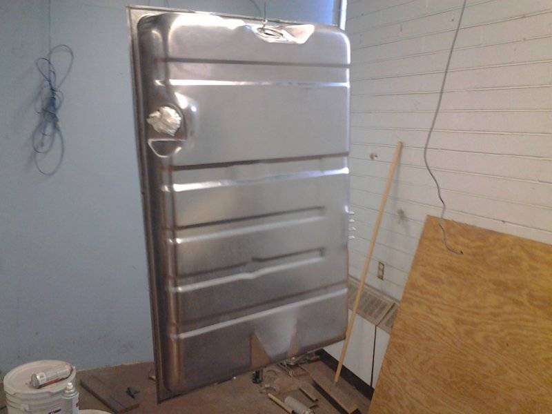

I dug out the new gas tank with ECS for the N95 California emission package. I usually wipe the new tanks down with lacquer thinner, and follow up with Prepsol,then I use a high heat satin clear on the tank and straps to help maintain the natural finish.

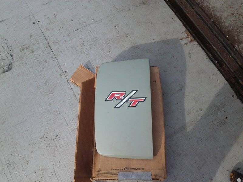

While digging through the garage, I found a gold nugget so to speak,that I couldn't remember where I put it for safe keeping. It is an NOS Charger R / T door scoop with the emblem in the original Mopar box. I had bought a new door scoop from Dodge back in 1983,after my yellow Charger R / T SE was sideswiped by a hit and run driver at a party. My girlfriend at the time said,did you take the door handle off the car? I can't open the door! I said no I didn't, she had drank a lot ,so I thought she was kidding, but she wasn't, the door handle was gone,so was the door scoop. The door was wasted,and half the quarter panel was dented too. I remember ordering the scoop,the guy who worked at Colony Dodge was a friend of mine, and had a nice 68 Charger R / T red 4 speed car. I used to sell him parts for his car,so he took the extra time,and searched the whole Mopar parts inventory for me. I had him look up the scoops,rear finish panel, rear valence pan, valence corners,and both rear quarters. The only part he found was the right door scoop. I paid $83 for it. I put that one on the yellow car,but the packing slip for the dust covered door scoop, had this note written on it,"last one,do not send back". The one scoop was the only available piece I could get from Dodge in 1983. When I traded my 69 Charger 500 to Troy, he included in the parts
package this Left NOS Charger R / T door scoop in the factory box. After I had purchased a nice pair of door scoops for thd Daytona stock car, I found that I also had 3 more door scoops up in the loft already,that I found while searching for parts for this project. Today I also found that I had already ordered a bunch of AMD parts for my sunroof car, I am just getting ready to place another AMD order,it's always good to go back and see what you have before placing an order!

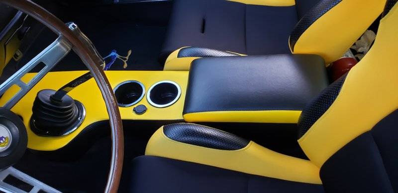

I didn't like the bench seat in my 70 Roadrunner, so I switched out to Scat Procar bucket seats and I got with Blue Thunder consoles and I have the first add on full console for a bucket seat shift lever manual transmission. Pretty cool!
That yellow and black theme really pops! It certainly is a modern take on a 70 style interior. I went with the orange and black 71 Road Runner interior,and had a custom cover made for the convertible rear seat in the Chargervert. I do prefer the 70 Charger interior over any other M

I finally got back to work on the V code Charger. Today I prepared the gas tank, by wiping the oils off it with lacquer thinner three times, then I used prepsol to wipe it down a few more times. I applied three to four coats of high heat clear with ceramic to try to maintain the out of the box finish.

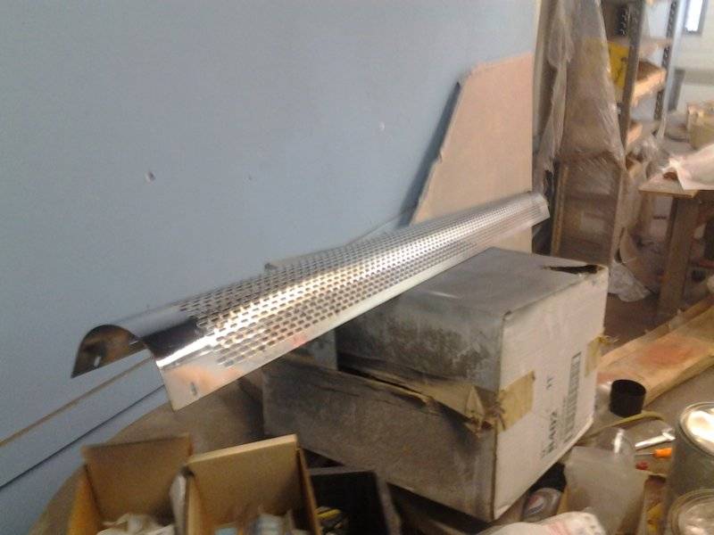

I also clear coated the heat shields for the side pipes on my 75 Dodge van. They started to get a light film of rust on them. I cleaned them with steel wool,and then wiped them with lacquer thinner several times from both sides, and followed up with the prepsol as well, then applied the high heat clear from both sides and from all directions to get the clear into the edged of the preferated holes.

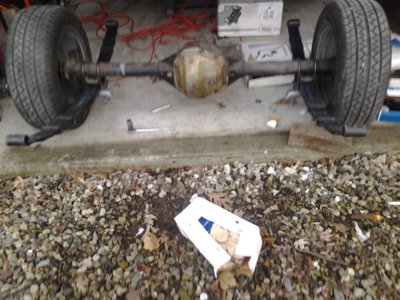

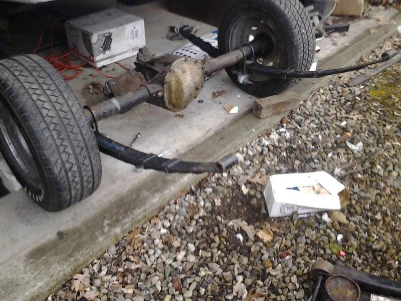

I got back to work on the Charger today. It was 60 degrees out,and that never happens this time of year around here,so I took advantage of it! I got the leaf springs installed on the Dana 60 rear axle. I noticed that the rear axle had old school traction bars on it,and the factory shock mount plates were missing, so I had to go up in the loft and find a pair of them. I kept finding all passengers side shock mounting plates,but no drivers side plates. I finally found a left one after finding three right ones first. It took longer to remove all the shipping labels off the new leaf springs than it did to install them onto the rear axle. Any forward progress is good progress, and today was a bonus day!
