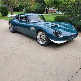

Why do you think coils are going to handle better than torsion bars? What do you epect to gain by swapping leafs to something else? Or are you looking to change geometry? You still have to deal with bumps. Reinforcing for flex is always a good idea. Moving weight off the nose is good. Most of that can be achived with what basics you have. Be careful how stiff you go on the street. I Have a friend that just finished a home built road race style E type Jaguar with a hopped up 400 sb Chevy 5 speed. It has heims everywhere, stiff springs, and big anti-roll bars. Goes like a rocket straight and thru curves. It's loud, stiff, and bumpy.
Doug
