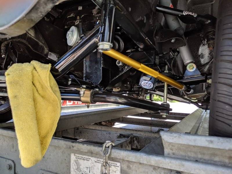

One of my gripes about the aftermarket stuff is the flimsy appearance. I used to build homes and commercial structures where we were required to meet earthquake standards. To me, more structure means more strength. When I see a tubular frame with long unsupported areas, I envision excessive flex. Look at the unsupported area between the yellow arrows.
Then we have this angle. That sway bar hangs way too low. The 6" long end link puts the end of the sway bar right at or below the rim edge. This is a bad design.

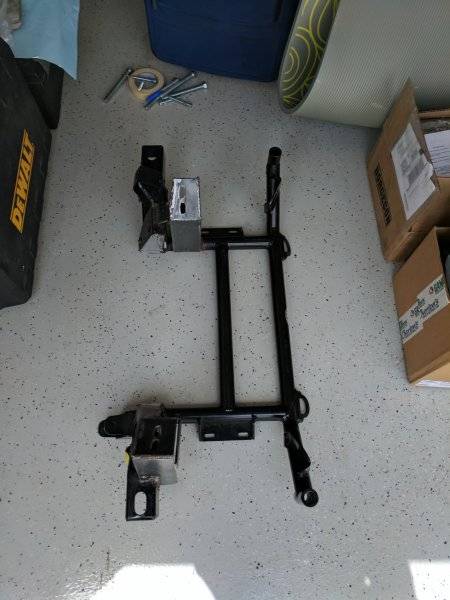

The stock B body K member isn't a cast iron lump...
Bare, mine was 45 lbs with the reinforcements that I did to it. Look at how much more stiff it appears compared to the tubular ones...

Can anyone be serious when they claim that the tubular design is better at resisting torsional movement and Parallelogramming?
How about adding some gussets to the QA1?
I know that it’s not favorable to by a new part and immediately have to modify it but sometimes that’s just how things work in the aftermarket.
More common that you think! The K member pictured above was modified to use 62-65 motor mounts in the original location ... as QA-1 did not make one for these cars. Note the two slots rather than the single ones on the later K members. Using it also lets you add a sway bar and provide handy tie downs. It is 1 of 1 and still available should anyone be interested.

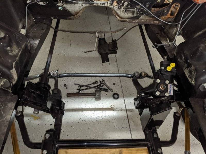

Well, I decided to give it a try on my 68’ coronet R/T.
I ordered the frame, upper and lower arms, strut rods and sway bar.
I’m going to pair it with Bergman idler/pitman/tierods/column bearing and a Borgeson box.
The parts arrived and they look great to me but we’ll see once the car goes together.
What ARP hardware should I be ordering for the steering box?
I’m just going to anticipate shimming the box and get setup for that in advance so I don’t get delayed waiting for a few pieces of hardware.

Thank you. Did you cut the frame side down a bit?

I did cut the frame side(shown in the photo).
Also used blue lock-tite when I installed them into the QA1 frame.
Use the ARP lube on the threads when installing the nuts.
I used 1 QA1 spacer only, on the frame side.
