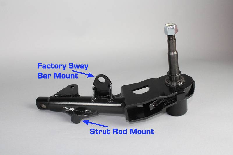

You can get the QA1 system one piece at a time
you don't need to do the whole thing
you can also get lower CAs with the tabs on them for a Sway Bar
you can correct the bump-stop if you go to the rack & pinion,
it's no big deal,
space the tie rod ends down on the lower balljoint steering arms
the purist will hate you & talk **** too
trust me I've been there
you can also use the stock steering box & even stock Torsion bars too,
depends on what QA1 kit or set up you choose
then don't deal with any of that or a lil' less anyway
of the steer geometry mods
(lack of turning radius is, with the rack, but can be solved easily too, simple redrill)
the whole deal k-member & LCAs, UCAs & dynamic adjt. strut rods
for the TB set up, not for coilovers
it only weighs appr. 38#s in the boxes to ship it, so a tad less, few #s less
minus the weight of the Org. TBs
as you know TBs are heavy
the brakes depending on what brakes you chose,
the brake you choose may weight as much as the whole suspension system does,
depending on what brakes, what brand disc or drum etc.
you can use your stock spindles & lower ball joints too

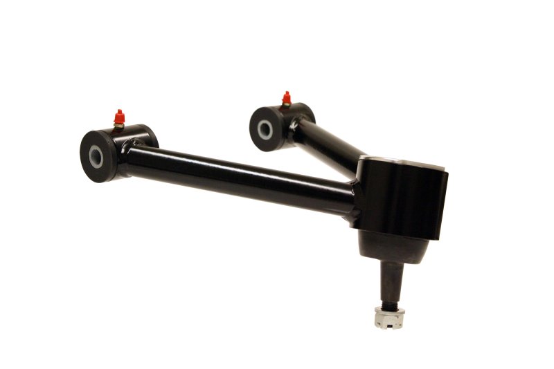

even UCAs with dbl adj. so you don't have to remove to do adjusts

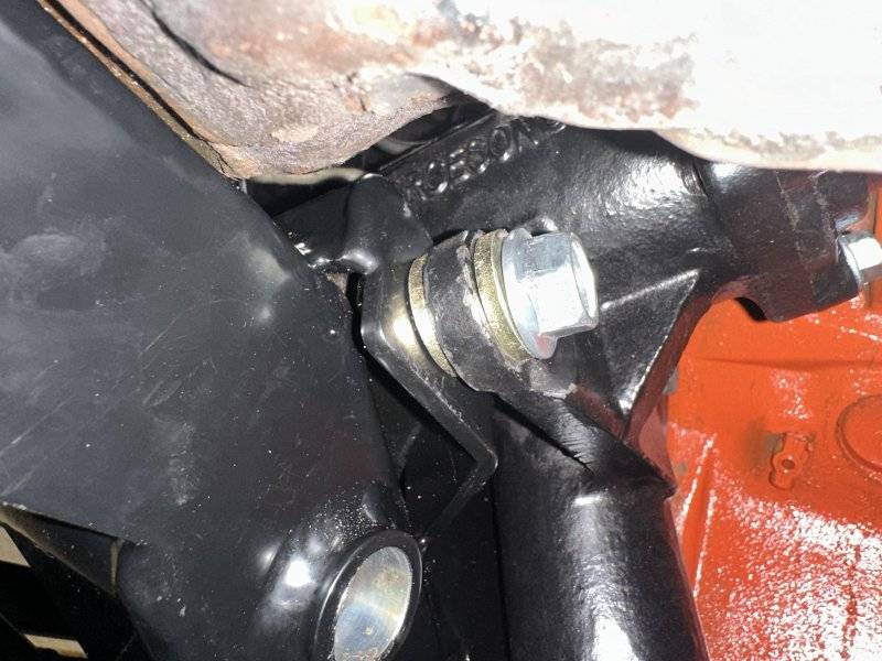

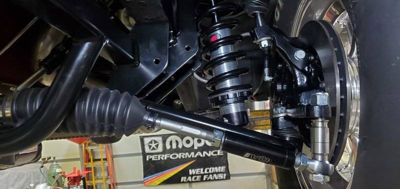

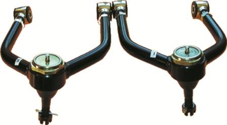

adjt units
Suspension Mopar Performance {Capps Automotive} Mopar B-body Adjustable UCA's.jpg
On the 3rd one, I used these UCAs instead
SPC Dbl adj, not cheap
they have an improved version now too

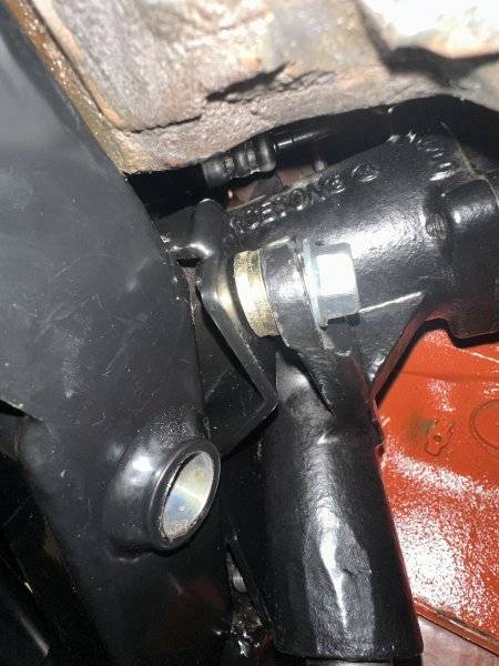

the Unisteer (rear steer Omni rack) bolt in stock mounts
the rack & pinion system I used
$1,000 spent, I thought I was doing well, it has room for improvement
& really limits the headers you can use
you can make your own headers (most couldn't do it)
if you want to buy them,
the only ones on a B-body will work is TTI-383178ci (IIRC)
the rack feed lines is in the way
It's on there now not going back...
But also;
It does have great feedback thru the steering, very positive
it needed a lot of bumpsteer correction but no big deal

you could use your stock torsion bars (look at the LCA's photos)
stock steering box & draglink, tie rods, spindles & brakes etc.
if you wanted too
When I purchased the QA1 Stuff,
it was less than $1,600, for what I listed shown in the photos
UCAs, LCAs, K-Member, Dyn. adj Strut rods & Bumpsteer correction
it's been on my shelf for a while (same thing is like $2,000 now)
I bought 2 sets at the same time, at $1600 each
& not even both sets were anywhere near $5,000
not even if you include the stuff that has nothing to do with QA1
like the spindles (OE free reused), lower ball joints (Moog $79 ea)
Torsion bars (OE free, can reuse) the brakes (SBC $800-ish)
Edelbrock shocks ($100-ish (?) ea)
& rack (Unisteer $1,000, back then) QA1 Bumpsteer kit (IIRC $99-ish)
sway bars for front & rear (Summit/Hellwig $300)
it's all still nowhere near $5,000 for one set
my labor is free, just cost years off my life
it was weighed at the local UPS store,
I think their scales are somewhat accurate, that's what they base the charges on
if anything they are on the heavy side
I didn't say the whole thing only weighed 38#s
just the QA1 stuff in the photos & the SPC UCAs :blah:
& that was in the box for shipping, so that was even lighter than 38#s
None of what I mention below
is anything to do with Ford Mustang II or Pinto crap
it's all MoPar specific
it's no big deal,
maybe they bought the wrong stuff
I really don't know the hatred & bias of why
I don't care
the coil overs setups are far different than the kits
for use with the stock style Torsion Bar & stock steering
Not all kits are created equal
most order willy-nilly & don't do the due diligence
don't know what is what
& it's not for everybody
I liked them personally, I like the looks too, functions right
to each their own
do what makes you happy
Talk about people 'lack of creativity & thinking outside the boxes'
I've had the Capps Automotive,
that was really the only MoPar specific stuff made at the time
prior to QA1 (QA1 bought them out)
a few others brands have tried & went belly up or sold out
(hard to please that crowd)
then I later went with the QA1 stuff on 3 cars now,
you can get poly bushing on either too
you don't have to run coil overs & or any Hiem joints, depends on what you want
or
if you prefer Hiem joints
again it depends on what you order & want, what you order
I don't care what you want you or what you like I don't put people down for it
you shouldn't care what I want or like
why the animosity/hate towards one system/brand or another
from guys who highly modified the org. parts,
nobody cares there, nobody put them down
or those here that just preach that only Ma-MoPar knows what's the best
(no just they are the cheapest to produce, they need mods)
'all the rest suck' mentality if you don't take their advice
Now are they (QA1's) 100k-mile parts, I doubt they would be
they do also have replaceable/seviceable parts too
that's not what I'm after either, I wanted weight loss,
& I like the look too
(who of US all here hasn't done something on a car "for the looks")
& adjustability, I got both & successfully I may add...
I drove mine on the street & mountain roads for years, very good handling too
decades even now
I have another full set on the shelves
I'd 100% without delay, I'd use if I wanted that style of build again...
I've had no failures, their quality has been really good
I had about 30k miles on the last car,
about 12k on the one before, the car before that was a track only car
2) 68 RRs & a 68 Sport Sat. all b-bodies
One the silver car (street/strip) that went 8.58@ 156
I never had any problems, nice adjustability, more than I needed
way more than stock, especially if you have ride height changes
Pluses;
great for oil pan & header clearance 'without the Torsion bars'
but then you need to do the front steer & coil overs
IMO that's probably a race only setup
it's not as ideal
(If I was going that route I'd do Struts instead, make my own K
it's no big deal,
minus the Torsion bars

I installed QA1 strut rods and LCAs on my '66 Satellite about a year ago. These are my observations:
+ Installation of strut rods and LCA was simple and straight forward. They seem to do everything at least as well as the old parts.
+ No problems with alignment.
+ The adjustable strut rods allowed us to set up the front end the way we wanted and don't have rubber bushings that deflect under pressure.
+ The car drives and handles really well.
- I can't jack the car under the LCAs the way I used to (probably not a bad thing, actually).
- Can't use the factory sway bar or any of the bolt-on set-ups. The sway bar tabs on the LCAs are inboard. I think the QA1 sway bar might work with the later K-frame, but not the original one for my car. I tried the Hellwig sway bar with the bolt-on tabs, but the sway bar links were too close to my strut bars. There may be a way to make it work, but I gave up and sent the bar back to Summit. QA1 website indicates that I would need to go with a QA1 K-frame if I want to use a front sway bar.
I still have my original LCAs. I might rebuild those and flip the QA1 LCAs if I can't find a way to make a sway bar work. I'm not inclined to to do the K-frame swap. Seems like a lot of work and expense just to add a sway bar.

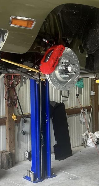

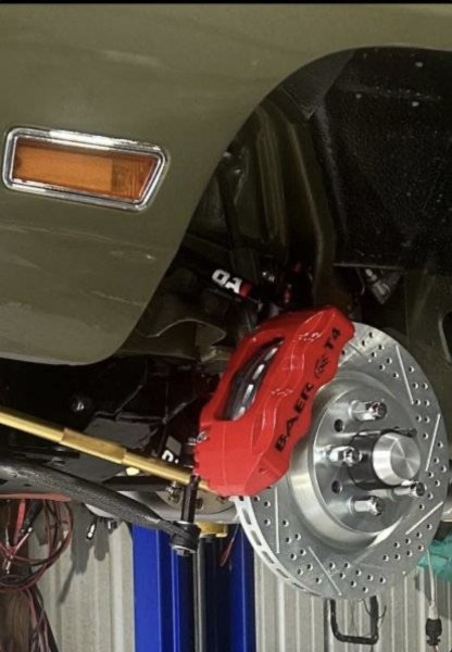

QA1 is sponsoring me this year, and I am installing the following.
K frame 52315
Sway bar kit front 1.25”52860
Torsion bar adjuster kit 52360
Dynamic strut bars 52312
Control arm kit upper 52305 (Proforged ball joints/not QA1)
Control arm kit lower 52308 (rubber bushing/not greasable)
Still need/want:
Front shocks TS501
Rear shocks TS901
Tie Rod sleeve 52325 for 9/16” or 52324 for 11/16” thread (not sure if I need 11/16”’s)
I was in the process of restoring my original suspension, I bought everything to redo my original.
In December I applied for their sponsorship.
I was approved in January.
I was just going to do the UCA/LCA and strut rods.
I have mounting tabs to mount the original sway bar to the QA1 LCA’s, so that wasn’t going to be an issue.
Then I noticed my factory k frame drivers side LCA mount had been repaired, and it was broken again.
Instead of trying to repair it, I opted for QA1’s k frame, and sway bar.
My original sway bar was being rubbed by my tired on turns (15 in. x 8 in/ with Cobra GT, P245/60R15).
The QA1 K-frame 52315 is installed, I did have to use the QA1 steering box shims for the Borgeson steering box.
I did reuse the original grade 8 bolts on the rear of the frame, and purchased grade 8 5/8x4.5” bolts for the front.
I’m contacting QA1 Monday, to see why my idler arm is loose in their mount.
I have a TRW idler arm, looks like the Moog K7041. Maybe I’m missing washers on either side, between the arm and the mount.
I’m excited to see how it handles when completed.
I am going to finish restoring my original parts, and see if I can reweld the broken mount on factory K frame.
I’ll keep all the original parts, in case I need them.

I’m happy you’re getting sponsored by them. I absolutely did not like their K-frame. Sent it back to summit. After shimming the Borgeson and then the way the sway bar mounted to their K-frame, nope, didn’t like it all and I called them and told them what I didn’t like it about. I’m running Viking adjustable shocks.
The QA1 sway bar is similar mounting to the 1970 style change, without going through the K-frame.
I agree on the Shimming, i had it strip out. Horrible design maybe add a welded nut the thickness of the shims.
