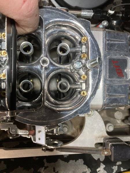

Has anyone else run into the problem of the 66/67 b body gas pedal assembly not providing enough travel to attain full throttle on a 4150 Holley carb.
I’m currently using the 1/4 inch hole that is closest to the throttle shaft center line. A Lokar cable assembly but stock gas pedal and bell crank.

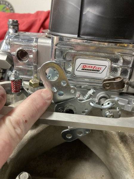

Holley Throttle Lever Extension 20-7 is what you seek...​

I don’t have the holley bracket that’s available as I have no need for kick down stuff (manual valve body).

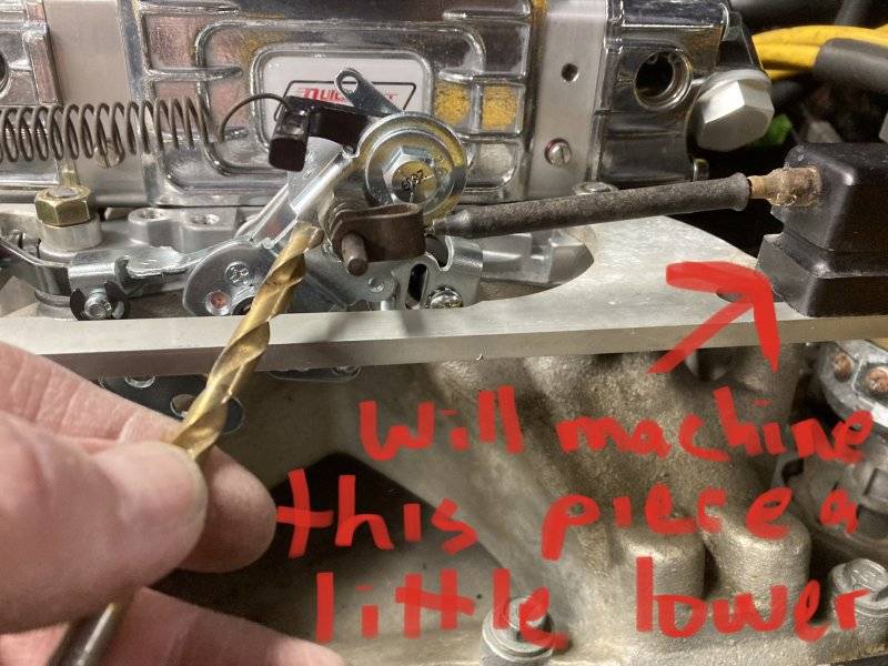

finger points to the hole I used. Drilled out to 1/4 to accommodate the stud.

Just drill the hole. You are only enlarging it a tiny bit. Yah I know, you’ll be thinking why am I drilling 800 dollar carb. Lol. But once you’re done and have full throttle you’ll get over it. Lol

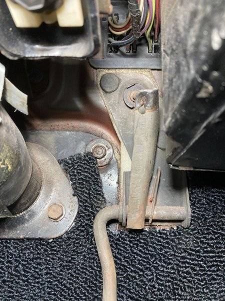

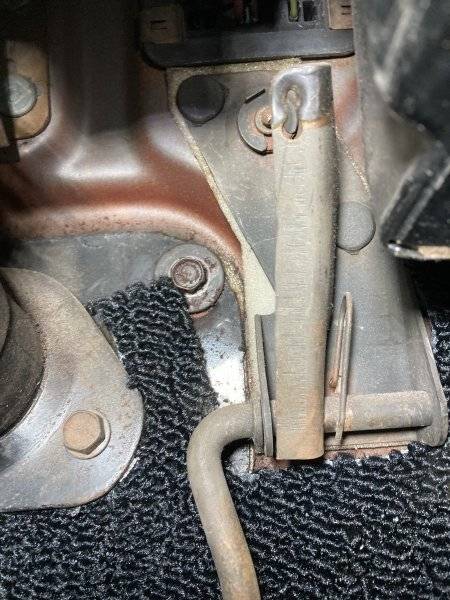

Also, make sure you getting the most travel possible out of your pedal. The lever which holds the cable on my pedal was lazy and laid over from the factory. the maximum Distance from the lever where the cable seats in the lever to the base of the cable washer/clip (total travel) was about .750”. Once I aligned, straightened, and tweaked the lever I increased the lever travel to about 1.1” Which is a substantial gain. A small gain at the petal is even more at the throttle shaft.
I had 5 or 6 spare pedal/pedal brackets and the all ranged from .75” to about .950” at the most. Quite a varianc.
you‘ll probably find threads on people shimming and moving th whole bracket away from the floor and 1/8 - 1/4" but I don’t like that idea too much.
I didn’t take a picture of the lever after but it is aligned square and high. These show the poor alignment and lazy/bend

So less than 3/4 of an inch is shooting for when the pedal is as high as it can be. Is that correct?
yes. When the pedal was as high as it could go I HAD slightly less than a 3/4” gap between the lever and the cable seat/base. I wouldn’t shoot for that amount. I straightened it all got 1.1-ish gap, hence increasing the amount the amount of cable pull prior to the pedal bottoming out.
make sense?
you want more cable pull before the pedal bottoms out. The use the hole I suggested on the carb for the throttle stud and should be off to the races..
