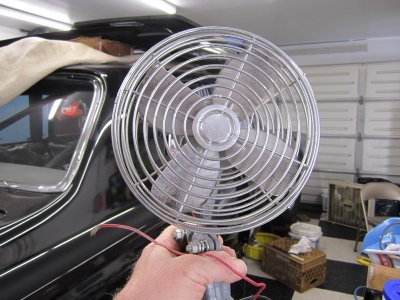

This is what I use without a mechanical fan becausr there is no room for it.A pair of electric fans that were wired for pushing:icon_viking:

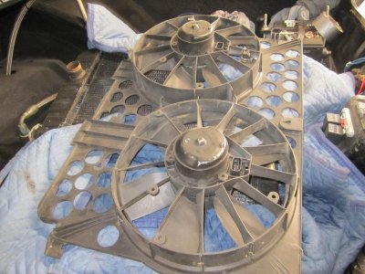

NO,NO,NO!!!That my new air conditioner,these are my electric fans:blob1:
