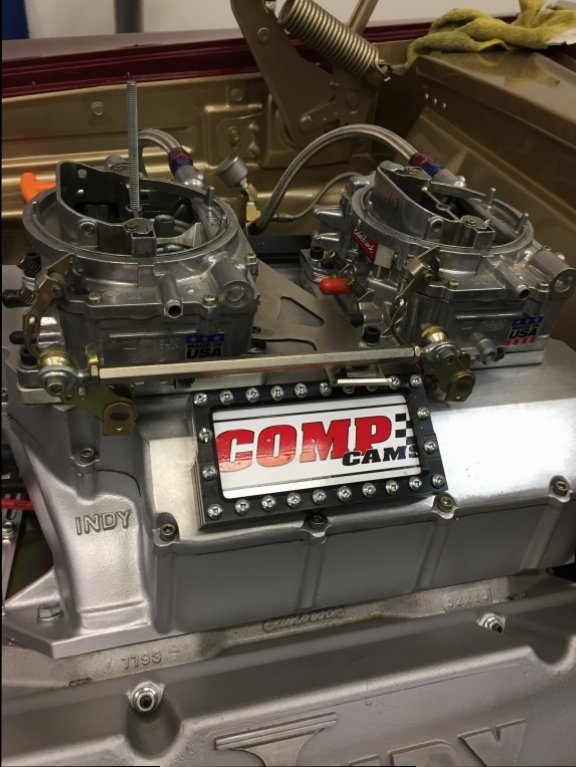

Looks good. What did you end up with timing, jets and rods? Any lash changes?
Final run was with 36 degrees timing, 110 jets, custom 7038 rod, .015 intake, .020 exhaust. The custom rod is because we were limited to jets and rods as our local speed shop has gone racing. We found that it wanted more fuel and more intake lift. There might be more left in it, and perhaps even more (or less) with a Super Victor and Dominator. The 505 never quit increasing in power with each step up in fuel. It loved it's fuel, that's for sure.
I would start out at the track at 42 degrees and go up from there. Personnaly haven't seen much gain beyond 32. Your jetting beyond stock calibration is +12_primary, +4% secondary. I would balance it by going to either 107 or a .042 rod in the primary and up the secondary to 113. This will result in 8% rich pri/sec . Then stay at That split going up or down. One rod or jet size by itself is roughly a 4% change. Stock is pri 113/.047, sec 107.

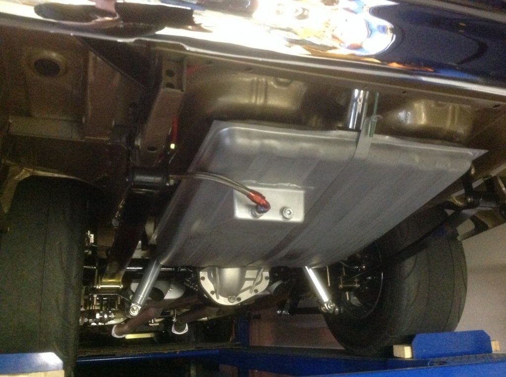

I've got your suggestions noted to try Doug, thanks! When I built the Plymouth I went with just the 6 point bar with intentions that it would never be an issue. I think that once I get the Plymouth chassis working good it could be close. From suggestions of Superstock and Mike, some double adjustable shocks would be a smart choice so those are now on the list.

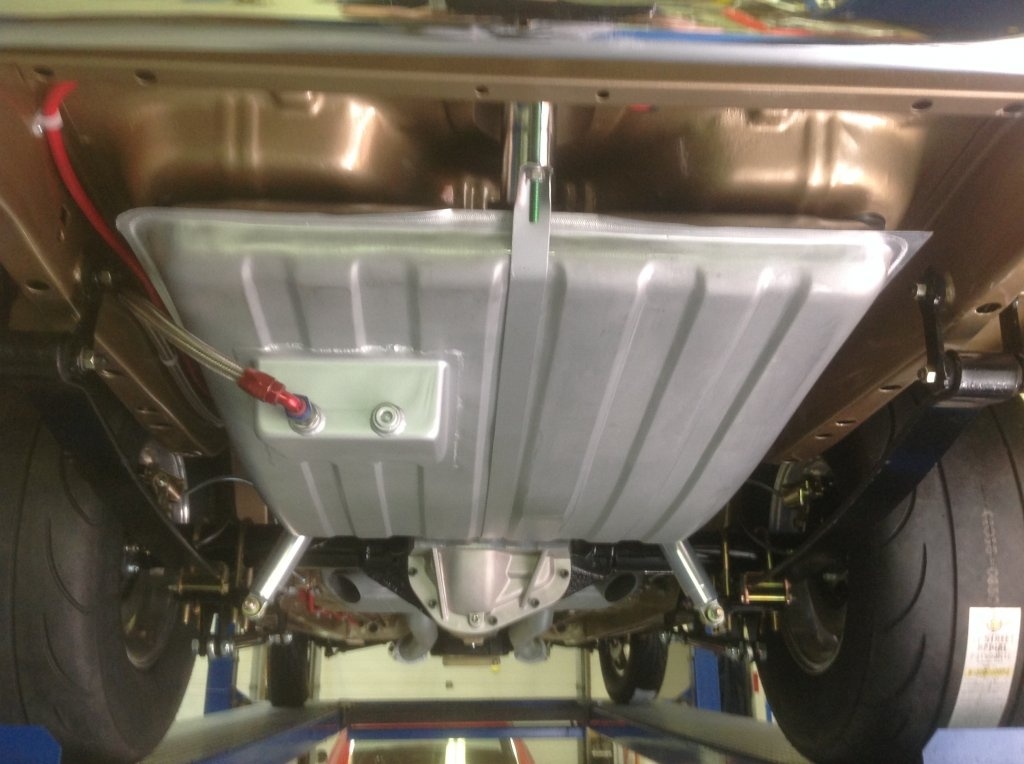

Can you fit a set of double adjustable coilovers out back or will your rear axle tube interfere with the spring?

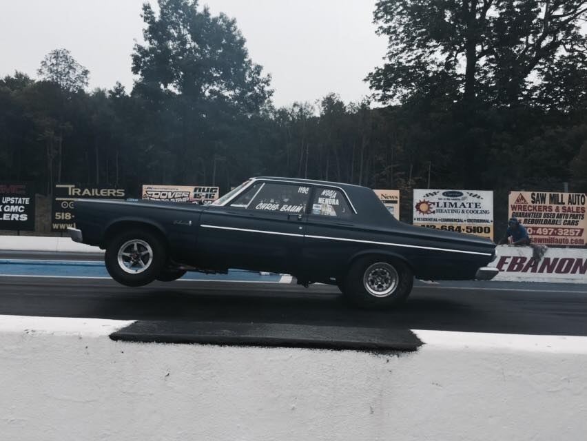

I think 36 degrees will make you 60 foot better, might make you ET good but your mph will be down.
My 63 likes 35 degrees but would love to try 33 degrees for little more MPH but I know my 60 foot and ET will suffer.
It appears there could be room for coilovers on the rear. How would coil overs on the rear be better than a double adjustable without the spring though.

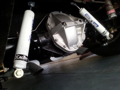

I use the cal trac 9 way Adj rear shocks set on "9", full stiff (like cal trac tech told me to do).....hoOKs great

The reason I said coil overs is because you could set your ride height with coil overs and really fine tune your suspension.
But I think with the caltracs, the spring will adjust your ride height.

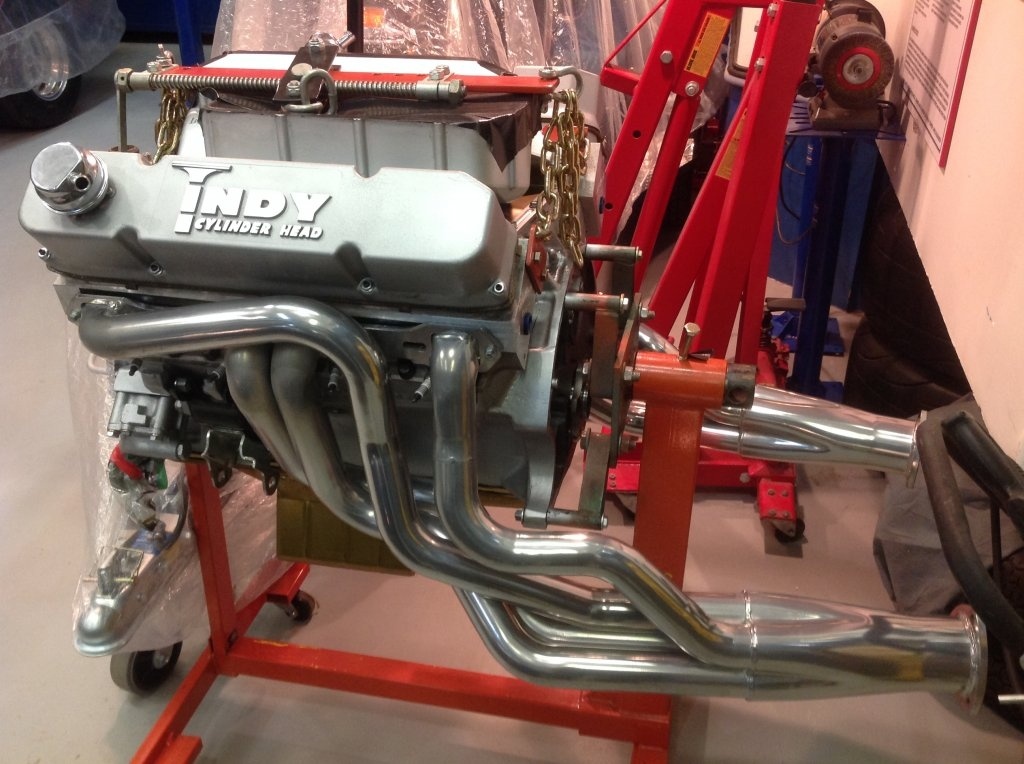

With the dyno tests earlier this week and that leaking rear main seal the headers really took a beating with the oil getting thrown around and baked on. Many runs up past 6700.
Got to say that the TTI headers with the ceramic coating are excellent. With some elbow grease and a metal polish they cleaned up well! It was a good choice to go with TTI.

Don't get use to shiny headers, oil **** happens, before you know, they'll begetting receramic coated.lol

I know that Cal Trac bought Rancho....but Cal Trac says these are "Cal Trac" shocks...9 way adjustable. I think they bought Rancho for the shock making capabilities.
Pictured below is a Pix of my Dana Rear End with the Cal Trac Setup.

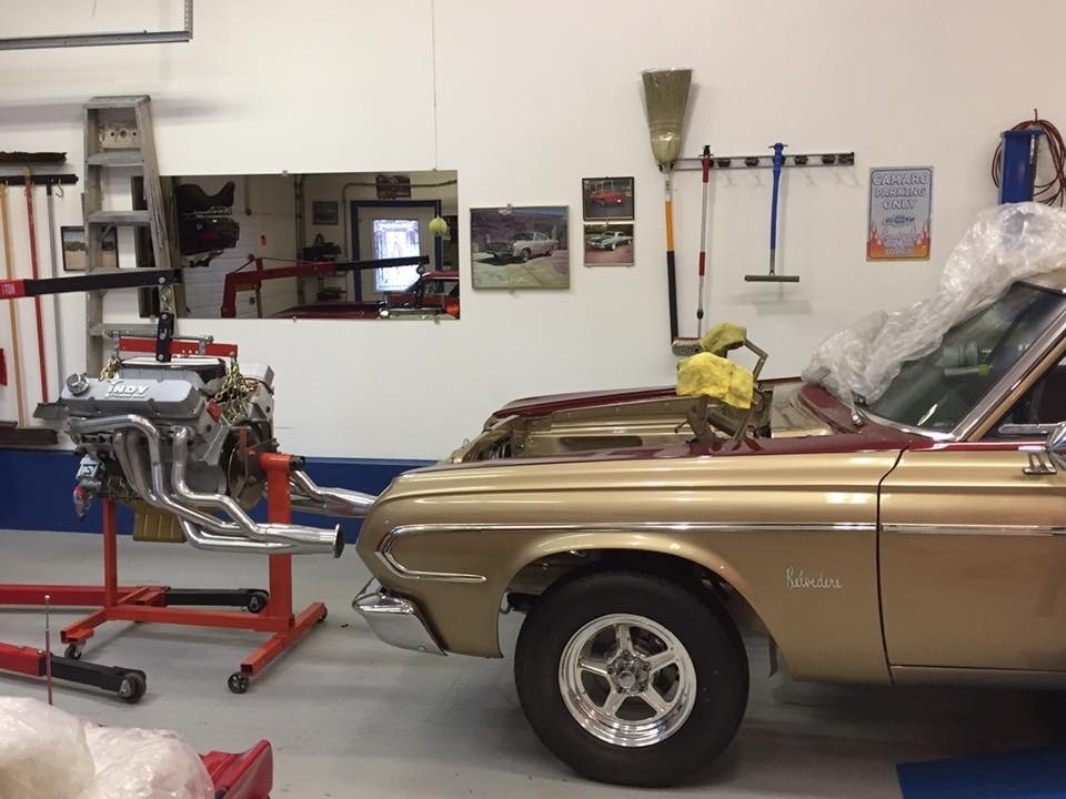

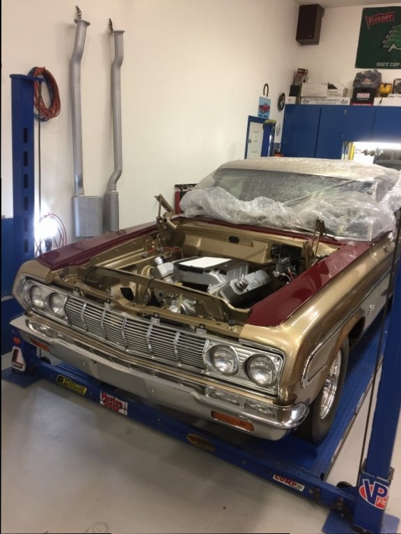

So making progress with the Plymouth and everything's going together. Got to drag this out and make it last! Still lots of winter to get through.

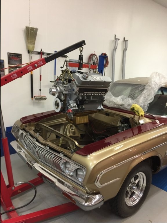

Things lined up and ready to go. Had to split the intake in order to get the engine high enough to get past the rad support without incident.
Up and going nicely into place.
Sitting in place, ready to go up and button up the bottom.
