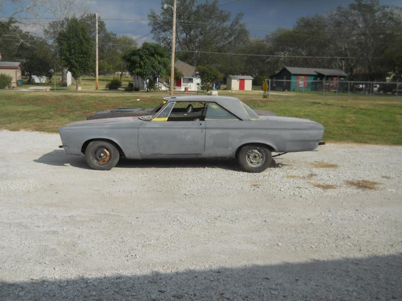

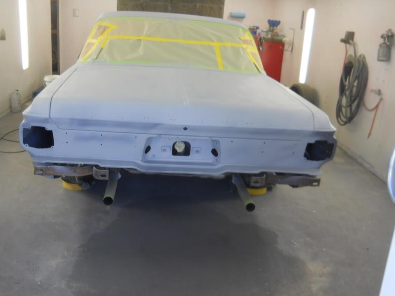

try going to your local auto parts store and check on helper shocks like Monroe sense trac. load adjusting shocks I put them on the rear of my 65 satellite and it sits with a slight rake @ $ 50.00 ea. it's like a coil over shock 027.jpg005.jpg you don't have to worry about an air line breaking. the ride isn't bad either.
