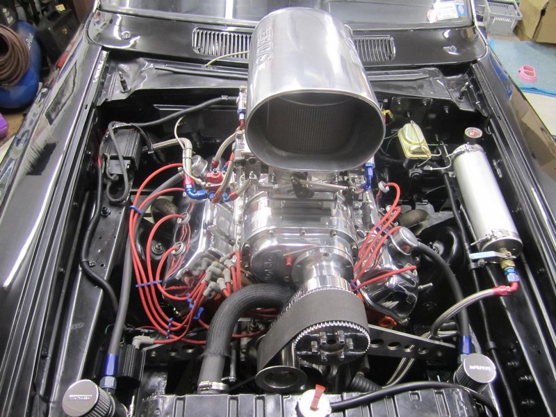

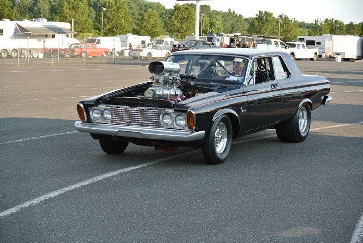

Nice set up ! What for boost you running and how is its street manners ?
I love blowers, even know theres better ways to go fast. you gotta admit that something like this will always be cool! Build your dream....
