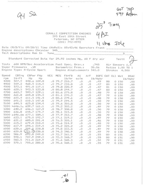

Callies 4.5 stroke,Diamond 8.5 pistons,Manley "H" beams,Comp roller.Siamesed block and iron stockish heads.
Here is 4 lbs of boost with very consevitive timing:eusa_whistle:
