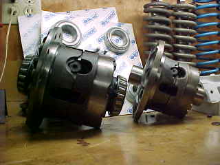

This goes back to the 'what one is better' when the subject of the cases comes up lol. Since BW decided this unit was to be a throwaway, they didn't offer rebuild kits, so a lot of people like the one with the plates instead of the cones. I end up with all of the 'junk' that others don't want because it's cheap so therefore, I have plenty of 41 case rears and the cone type suregrips

IF you don't keep hammering on a Suregrip that has quit working, you won't hurt it in most cases. Not sure about the clutch type but I'm sure it will tear itself up too if you keep on trying to make it 'posi' when it has long since quit doing. Ok, now, if you have a cone type that still has all of it's guts in decent looking shape, the cones can be machined to work again. Been doing this for well over 20 years and have several of them making liars out of several who say it can't be done. A buddy is running one in his low 11 second 440 six pack Challenger and has about 3 years worth and he runs pretty much all season long. Btw, there are many brands of machinery that uses cup and cone clutch design so it's not a badly designed unit. It was just meant to be non serviceable in an automobile.
