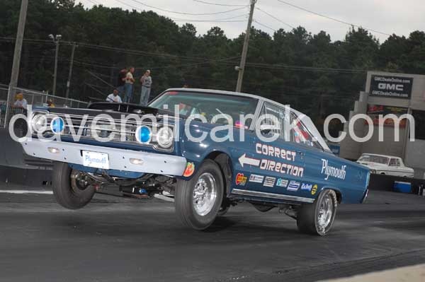

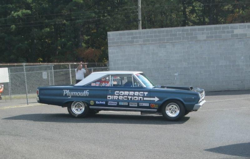

I use the MP 3/4 inch relocation kit from an A body with some mods to work on the B body with Caltrac mono leaf and bars. Springs are 1 inch lower as built from Calvert.
No binding, no pinion angle issues (stock location spring perches).
Simple and effective...

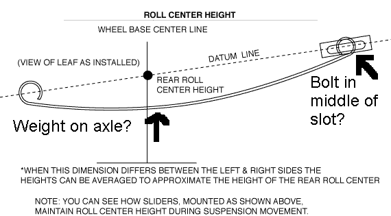

Those that are running these - where/how are you welding them in?
I have the speedway sliders - are you welding them in with the weigh on the axle and the leaf spring eye bolt in the middle of the "slot"?

on mine the spring eye is about 2 thirds to the rear of the slot with car sitting full weight
yes put the weight on the car and center the spring eye in the slider. you can add some washers to the insides of them to take up side to side movement, just not tight. the ones I get at speedway come with an aluminum bushing to replace the rubber one. It is sized for the B-body rear eye. too big for the A-body spring.

They work fine. Cheaper from Speedway Automotive. Fore/Aft movement has always been and still is controlled by the front spring eye. They barely lower the car. Pinion angle change isnt measurable. The biggest advantage is moving the rear spring attachment forward to a point that it wont bind the springs at max separation. If you're running radials you may need all you can get. Street driving isnt compromised. Our car has been 1.38 60ft with 3.55 gear on DOT radials using them.

The factory location of the shackle is generally to far rearward for drag racing. As the car separates the shackle pivots forward. When the shackle is parallel to the leaf spring the spring can not separate from the body any further. Separation loads the tire. The shock controls the speed of the separation. The slider allows more travel than the shackle. It is possible to move the factory shackle forward. However the slider is a cheaper, cleaner, and easier approach.

I had to UNweld and reposition the sliders as the were hitting the end of the slot in the slider:BangHead::jackoff::lol:

The main reason why I am so on board with sliders is actually watching them function on a Mopar by a forum member.
Just watching them work make them look like an obvious choice, even to a rookie like me (or maybe because I know so little?) so it's encouraging that you speak so highly of them.
