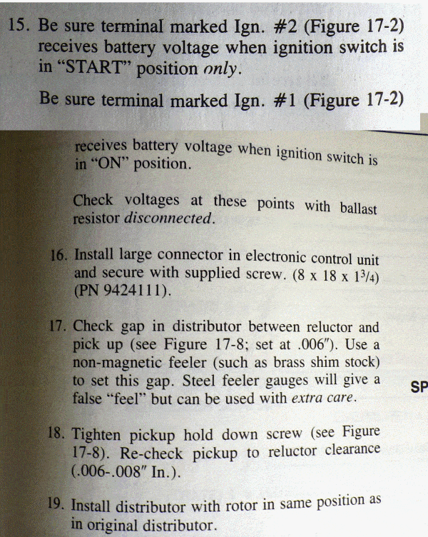

Ok. As for now, I've shielded off the wires from the dist. I also set the pickup gap to 0.008" and installed a new ministarter. Gonna give it another attempt later today.

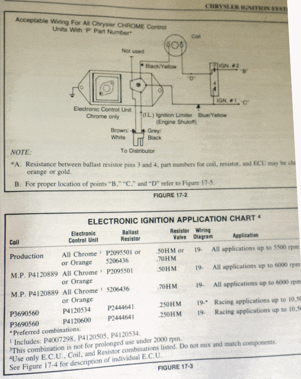

Is this an MP electronic ignition conversion? W hat are your components?

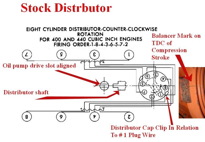

On the last pages there's pictures of torque secuences and other "good to have at hand-stuff". For example a very good photo of the firing-order of a 383...
Since this book been laying next to my engine the entire build I chose that photo to refer to every 1000 times I had the firing order double checked.
...But it's wrong in the book. They screwed it up, it's backwards. It really should come with some kind of disclaimer och warning if they're gonna keep sell it. (other than that it's a great book!)

Just now saw this thread, glad you found the problem. Yes, 1-8-4-3-6-5-7-2! I have committed it to memory long ago. Most any big block properly assembled with all systems working, plus cam and ignition timing set properly, will fire up almost immediately. I always set the balancer to the 15 degrees advance mark on the timing cover, then set the dist reluctor lined up with the pick up, and the rotor pointing to #1 plug wire. If you have fuel and compression, it should fire up right away.
