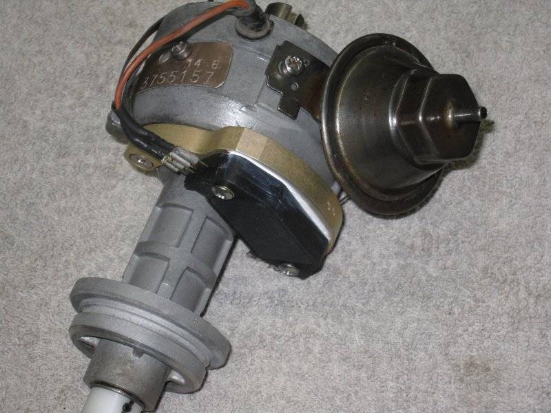

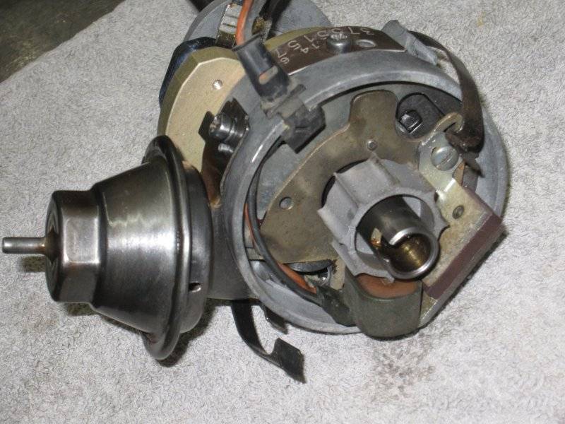

For cheap and easy electronic ignition, the 4-pin HEI module like in post #2.
My '71 Charger with FiTech TBI EFI is just running a stock 400 cid lean burn distributor.
Yup post #2. If you do not want to use a bal res, use an core coil such as MSD # 8207 or Summit # SUM-850500 with it. The E core coil gives more spark energy & you can 0.060" plug gaps.
