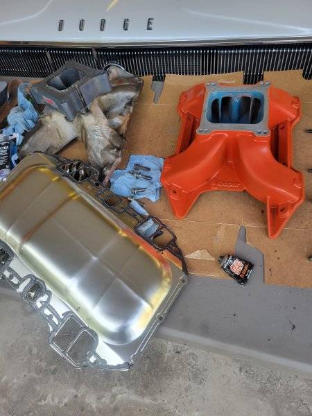

Unreal. I take manifold bolts were BARELY finger tight. Carb mounting bolts were also just shy of loose. Turkey pan was fine, but replacing anyway. I’m just shocked. Haven’t dove into the weepy carb yet.
Any tips for keeping the old RTV and flaking paint out of the motor while I clean it off? Thinking of cutting a piece of cardboard and seating it in there while I work to catch it.
Question: the strip pieces that hold the turkey pan down on either end have one side that's a 90 degree bend and one side that's sort of a blade. Which faces inside?
