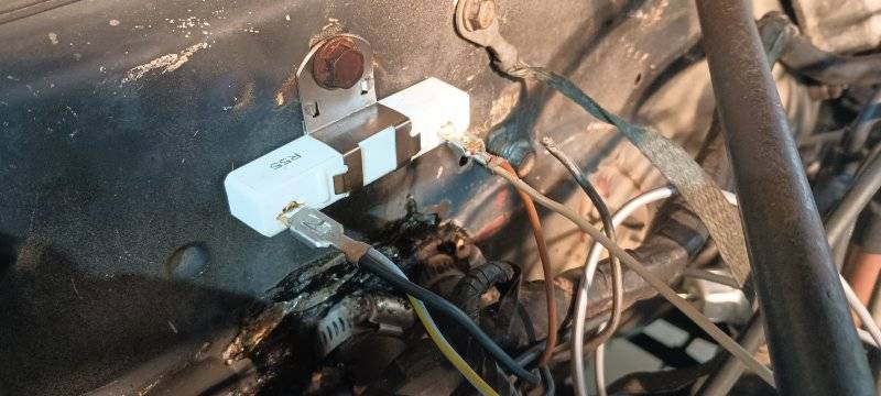

Concerning the HiRev 7500 kit sold by Rick...I followed the instructions that came with the kit...but the car won't crank. I'm posting a few photos here...perhaps someone can see an error in my wiring set-up. The vehicle is a 1979 Dodge with a 318. I'm a little unsure on what side the positive terminal should go on the ballast resistor....
Won’t crank or won’t start?
the ignition system hasn’t nothing to do with the cranking system. If the engine/starter motor is not cranking you have a diff problem what could be anything between ign switch, damaged relay, not operative NSS/clutch pedal switch (depending on year and model) or even starter motor solenoid?
ballast doesn’t have sense. You can plug the wires on either terminals. Diff is where you splice the harness for power included with the kit. The blue with yellow trace wire on new harness must be spliced on to the blue wire coming from firewall running to ballast, not to the other two which are brown and also blue if pre70 cars. Althought can be spliced also to the blue wire arriving to regulator and labeled as IGN on regulator for old mech regs(pre70).
but if your car is 79 it was already running on ECU, so why needing a new wiring? Unless damaged it should have been a plug and play job. Althought late 70s included several other accs related to ign system and lean burn system.
Nacho-RT74...won't crank. You bring up a great point....I'm going to check out the starter relay. For this project...I'm replacing the old lean-burn carb and distributor with the 7500. Many thanks for the feedback!
Ok.. as far I know on later 70s Mopars the starter relay solenoid works diff than earlier 70s providing the ballast bypass from there instead being from ign switch. But the basic circuit for cranking still works the same.
Yellow wire arriving to IGN prong of Relay. It should get power as soon you try to crank. If not, the problem comes from the ign switch, bulkhead plug &/or any other plug on the line (plug down steering column).
If you get power there trying to crank it from ign switch and still nothing you could have problems at:
-NSS at transmission not providing the ground on P or N if auto to close the relay circuit. NSS itself, or plug, or wiring between NSS and Relay. You can jump out that prong straight to chassis ground to discard. If you ground the at terminal (labeled as Ground on relay itself) and you get to crank then you found where is the problem. It could be even the transmission linkage out of adjustment or with some play due worn parts getting the gear linkage not propperly seated at P or N to provide that ground on the lever system inside.
-if you are getting ground at ground terminal (either from NSS or jumping out the ground terminal with chassis) and still nothing from ign switch the relay itself could be bad. You can jump out the big stud with the SOL terminal. A screwdriver or wrench can be used. Some sparks will come out, don’t be scared, nothing wrong with it. If still starter motor doesn’t engage with this, then the problem is on starter motor itself or wiring arriving to starter motor.
Nacho-RT74...many thanks. One wire from the lean-burn harness was freaking out on the starter relay....I had to ground it rather than it going directly to the starter relay. All is well now!
