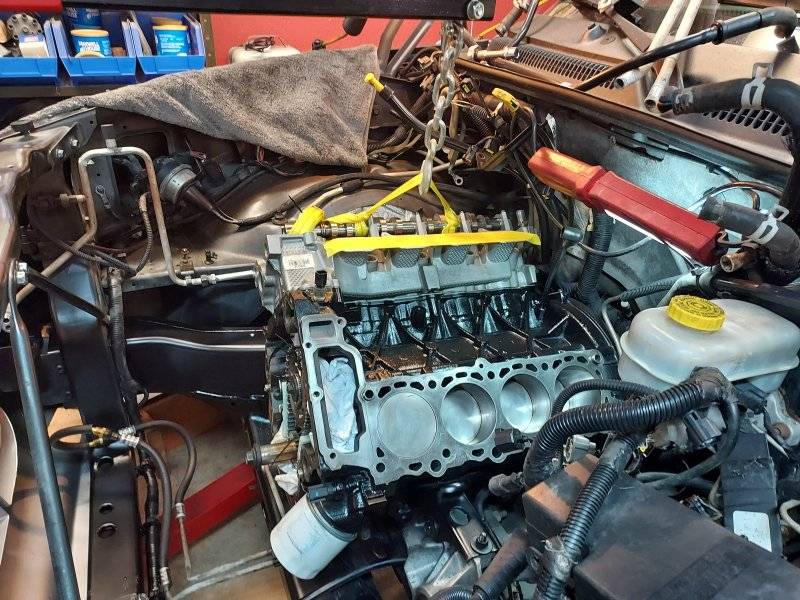

Well now that you mentioned it. It really is not uncommon and not that difficult. Protect the car, take your time, keep things clean, organized, take precautions to not drop things in the motor and pictures help. Nowadays make sure you have all your gaskets etc. before you tear it down. I took the heads off the Hemi this spring and I am still waiting for parts. I did manage to get other projects done though.
Engine Hoist helps!
