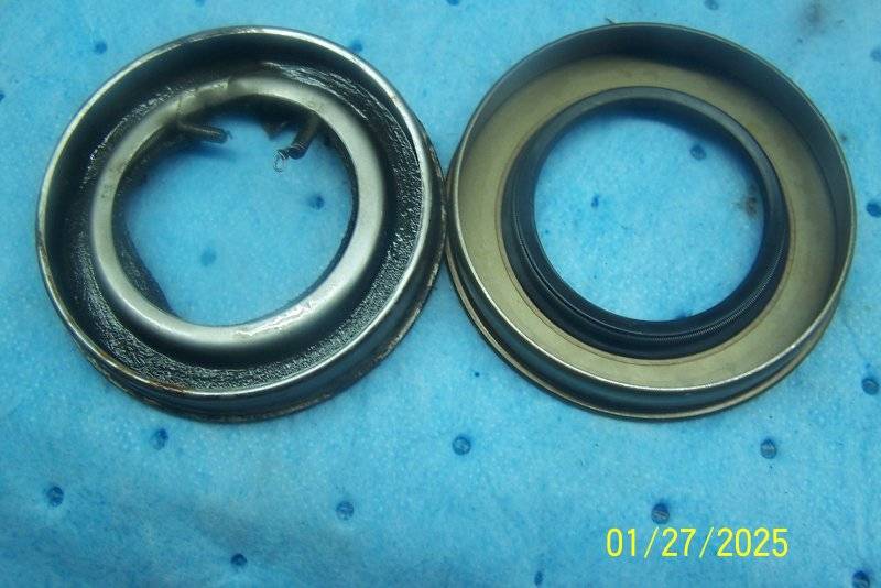

National still makes the correct leather seal for a 742
The seal on the right is the National seal. It is rubber not leather. It is their part number 7216 replacing the 1828719 mopar part on the left.
It fits but is not near as meaty as the original part. The National seal looks exactly like the seal I got from Dr Differential which is also rubber.
Parts guy I got the National seal from told me that Precision bought out National or vice versa. He was unsure of who bought out who but they merged.
Either way, the new rubber seal is doing it's job. Hopefully it will last as long as the leather one did.
C/R made the original seal on my Satellite. The seal PN starter 18xxxxx, your original probably has it?
Yes. PN 1828719. I couldn't find a C/R seal. All the parts houses around here have National or Precision PN 7216. If this rubber seal starts leaking, I will go back to the Mopar leather seal. It looks way more heavy duty to me.
