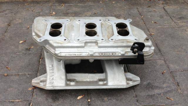

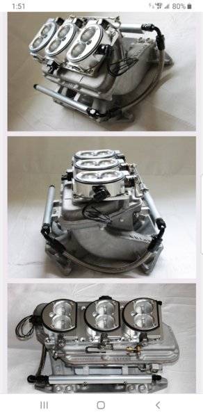

There's an A-bodies Only guy who has this Weiand 6bbl intake:

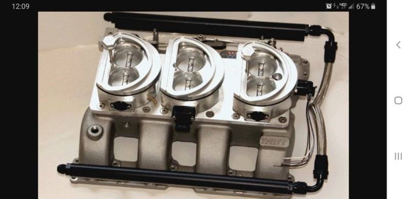

And he sent it to F&B, who makes these amazing 3x2 throttle body/direct port injection systems, usually with the Indy ModMan intake, like this:
View attachment 791840 View attachment 791841

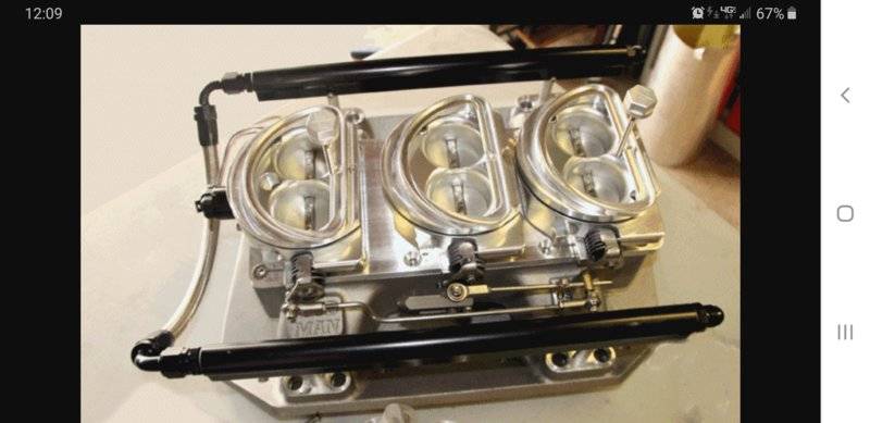

and they may be able to use my current Edelbrock/Chrysler aluminum 6bbl intake, but for the RB stroker the A-body forum member has, they did this with the Weiand:
So I have other priorities, but I want to think I will live long enough to build my stroker motor, and I sure would like to have the Weiand to top it off with.

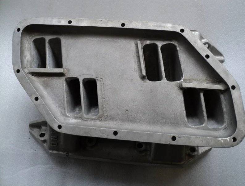

I may play with the Promax modded Holley carbs I have now, and put them on the Weiand with the recommended "dams" on the floor of the plenum, like this:
but ultimately my vision is to have it setup by F&B for EFI.
Have any of you run this intake or have good first hand experience with anyone who has?
Opinions and suggestions are welcome, even if it's something that may be contradictory to what I think.
Thanks!
Jed Scott at Scott’s Speed Shop on YouTube runs the Weiand 6 pack Tunnel Ram on his 505ci Charger. Think it’s 615hp, 650 torque at 10:1 compression. Makes good torque but I think it hurt the top end. I can call him and ask more specifics if you like. It definitely makes a statement.
