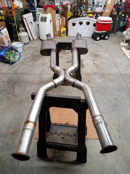

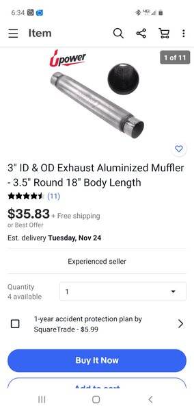

I added these to mine in the back beside the gas tank.I Lso have 3 in exhaust with x pipe but have magnaflow style mufflers.

Did it make much difference? Seems everything I read suggests putting them as far forward as possible?

I didn't have room except in the back. It's not bad. I had flow masters on it and the drone that comes from chambered mufflers is insane. After doing some research I found that magnaflow and dynomax are supposed to flow better and have no drone. That did make a big difference in my car and the other resonators that I added was just to take the sound down a little more and it did.
