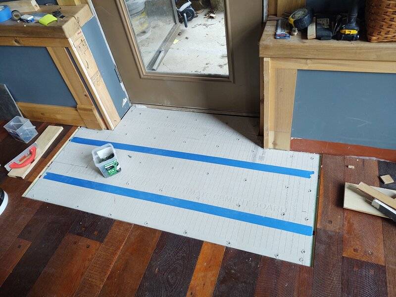

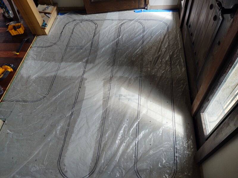

Took a break for my knees to heel lol. Here's how you install Hardie Backer board safely. They give you several options for installing tile over the Warmboard including uncoupling membranes but given it's aluminum I felt better using Backer board that gets screwed down.
This little area was easier, just 2 pipes under it.
